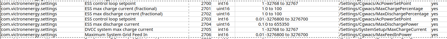

ssh and dbus-spy will give you a display that looks like:
so you should see writes to 2700 affecting the value in Settings/CGwacs/AcPowerSetPoint
and 2706 : /Settings/Cgwacs/MaxFeedInPower

so if you want to export power, 2706 must be set to -xxx*100 W, and then the 2700 register allows you to vary the power up to this limit. Note that this is also subject to grid code: some grid codes won’t allow you to feed in energy from DC battery or DC pv, regardless of other settings.
Note you may also have plc offset on your register address that will offset it by 1:
For my system as shown above:
2700 >> 400
2701 >> 20
2702 >> 100
2703 >> 4
2704 >> 100
2705 >> -1
2706 >> 5
Note that the system is not currently in ESS mode: Assistant has been unloaded.
