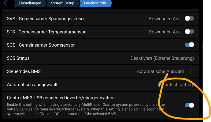

Did you switch this (see circle ) on?
Thanks DirkW, I turned it on in venus.local right after connecting, but I still couldn’t see the Venus quattro and its energy flow in the base panel.

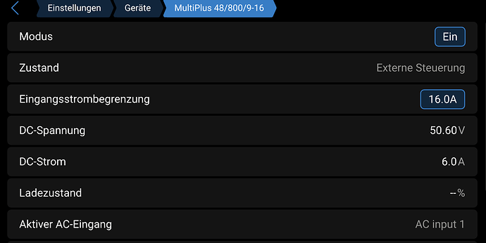

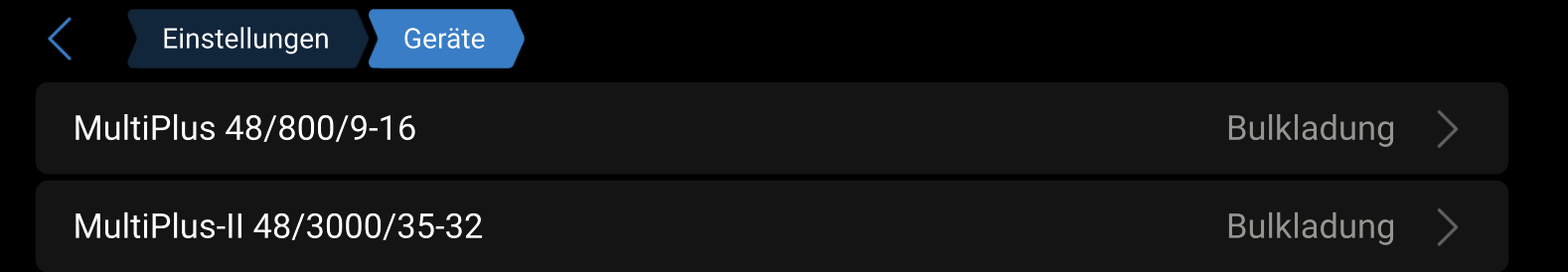

The 2nd MP does not appear as an additional device in the overview pages.
You can only find it under > Settings > Devices. Its operating values are also located there.
Simply configure it with the MK3 and victron.connect or ve.configure and then connect it to the GX device via USB.
Then you should be able to see it and flip the switch under System setup.
