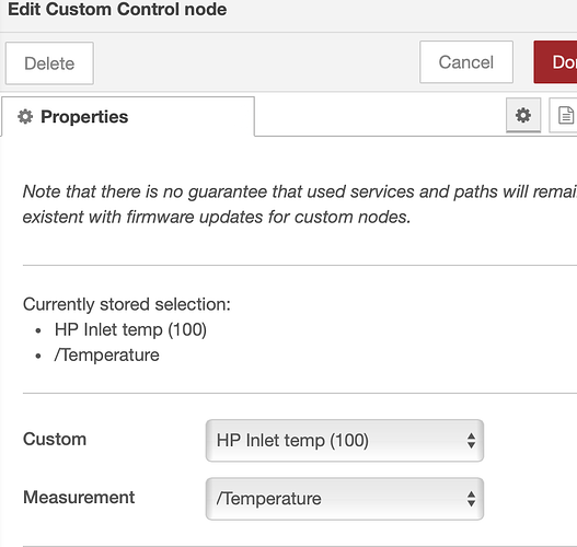

You’re reading not writing. Change the /R or just use a custom control node and the temp sensor will be listed there.
I get arbitrary data to a Victron virtual device through a Victron control node, which injects the data to the virtual device. The data comes from my external server, not dbus.
Is that what you asking?
