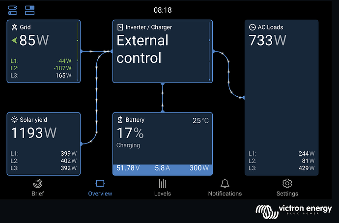

In my VRM the solar yield is positioned correct (AC out).
In the dasboard of the EVCS it is located on the AC-in side.
Can i change this somehow ?
Best regards

I second that. My solar is on ac-out, but the cerbo shows it on the left side, suggesing it is on the ac-in side. Please ‘fix’ that…

In VRM everything is correct displayed for the postitions.
The remote overview has the wrong position in this case
My question is - do you see it displayed wrong only after the latest updated? or this but is visible for a long time? I’m asking because I see it corectly displayed
For me it has been as in my picture since I installed the Cerbo (around januari/februari this year).
So on the cerbo screen it sis positioned wrongly, on the VRM dashboard is looks fine.
I think since the new GUI layout.
The classic version it was displayed the same as VRM and correct.
