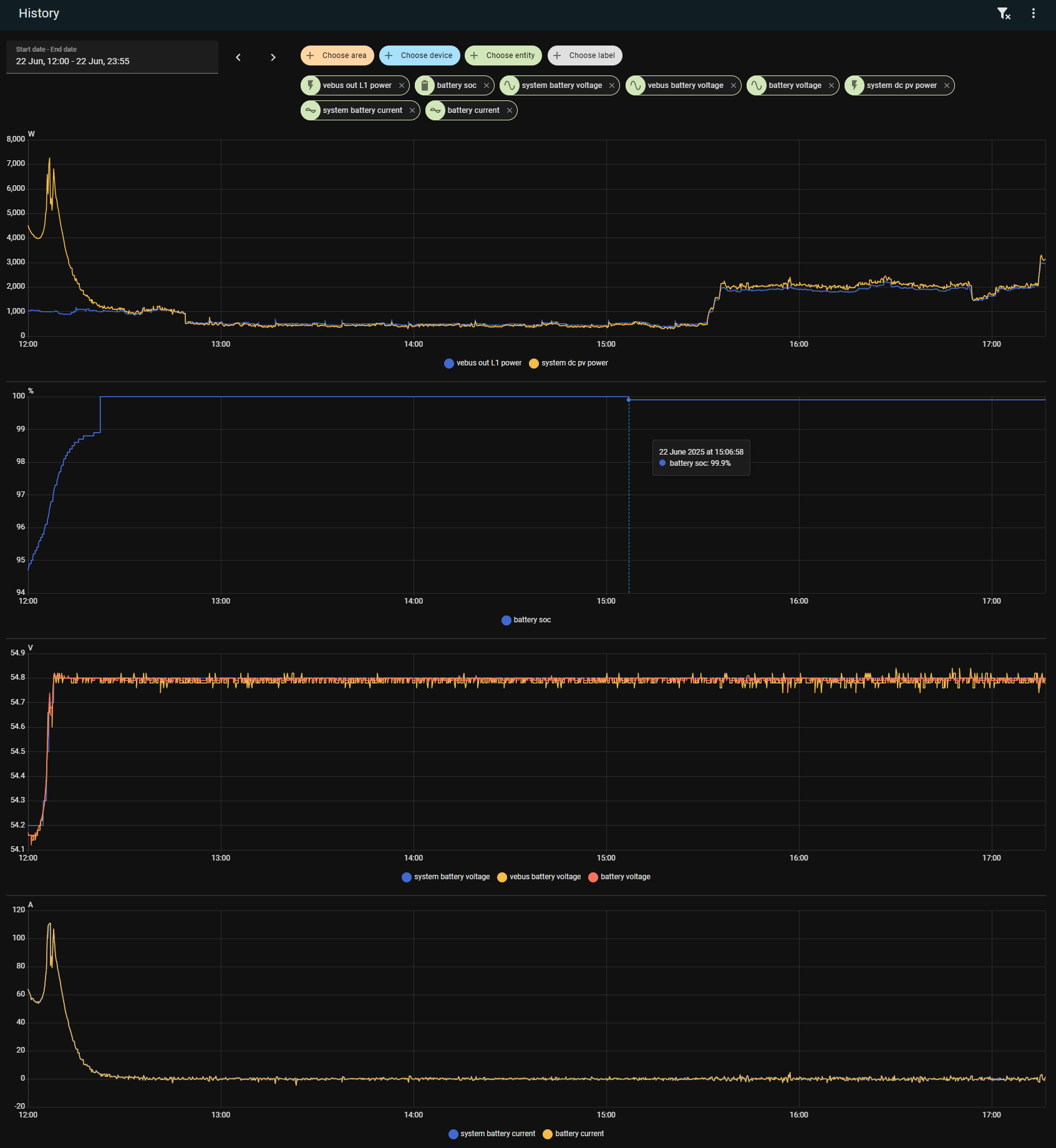

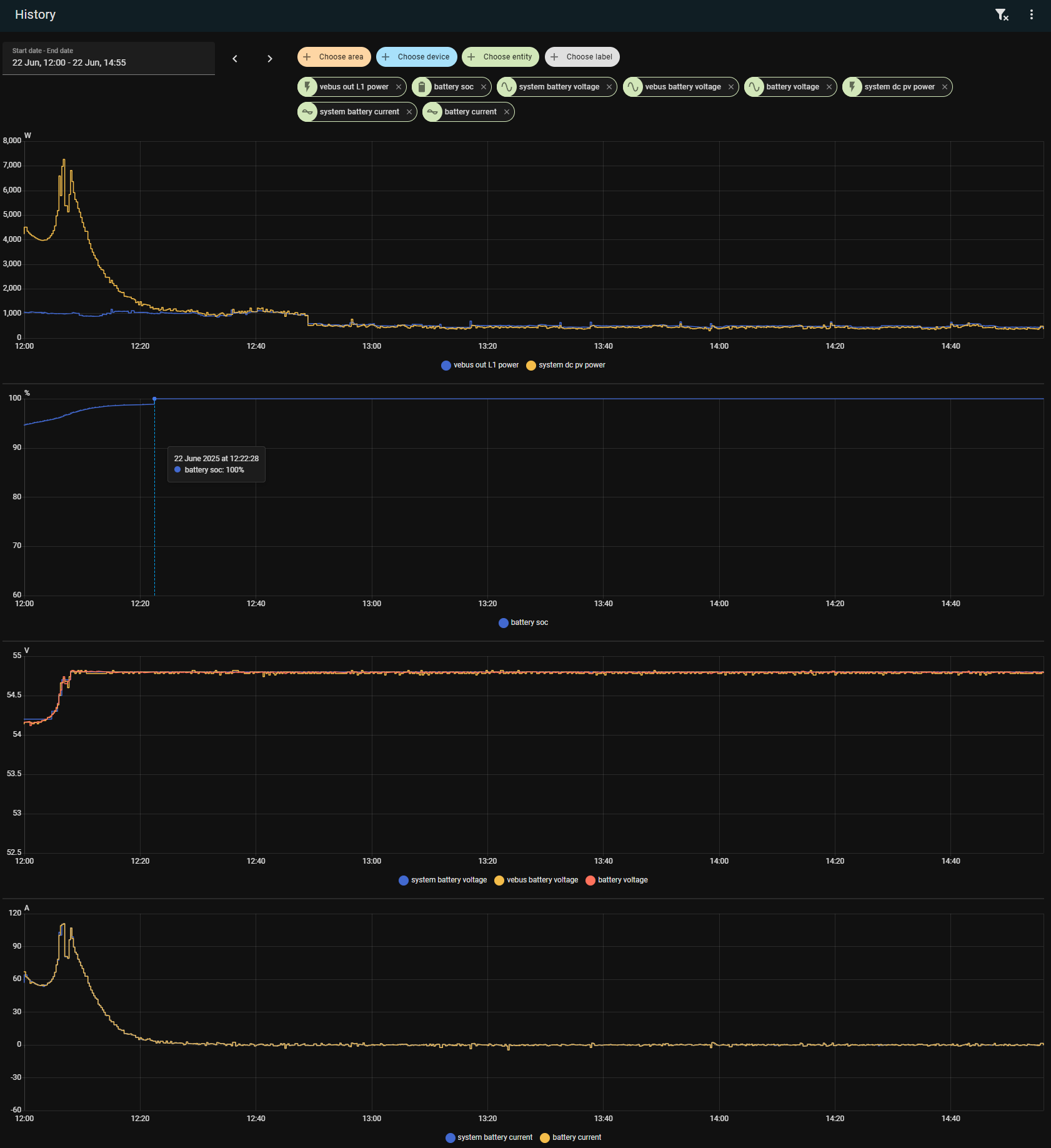

I lowered the “sync/charged voltage” to 54,7V, It will sync everyday now. I just need to keep an eye on the cell voltages and see if I need to force absorption sooner. Indeed, maybe the 7 days is not a bad idea. We see how will it evolve.
Why did you change it to so low a setting? It is even lower than the float value. I cannot oversee the consequences but I wouldn’t do that.
What is your reasoning behind setting that value?
Because if I’m not going under the threshold, the sync must happen just under the highest voltage of the day.
And if sync and the transition from Abs to Float is a different matter and are not related, this is the only way to sync everyday.

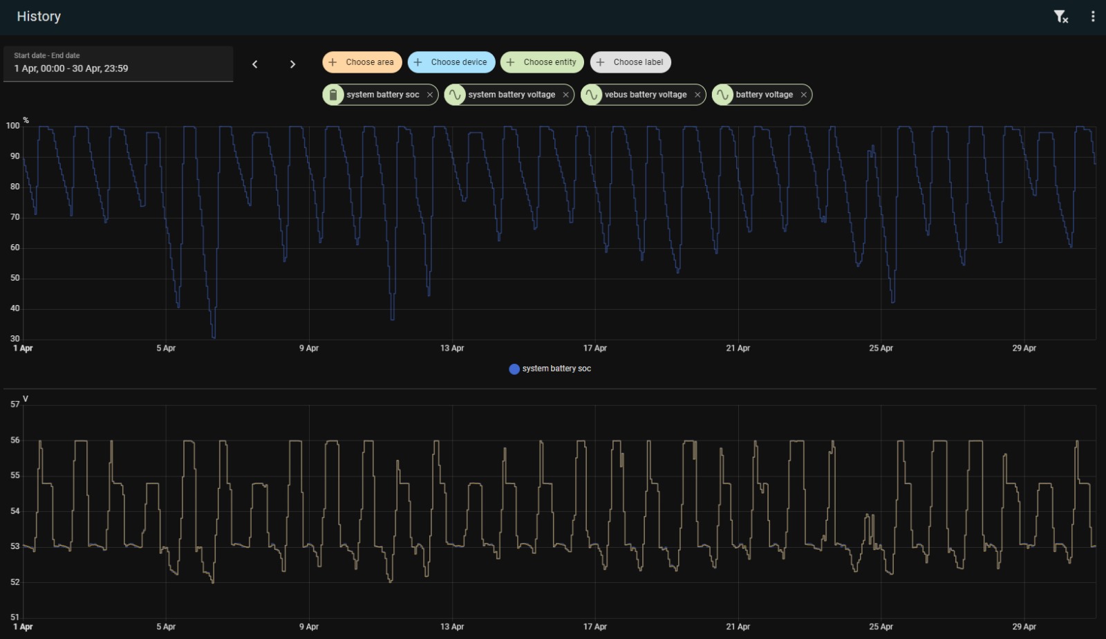

I understand this, but looking back in March or what it was, I had weeks at 56V. I much more prefer the 54,8V.
I’ll keep an eye at the cells, and either way if they unbalance, I expect the BMS to trigger 56V directly.

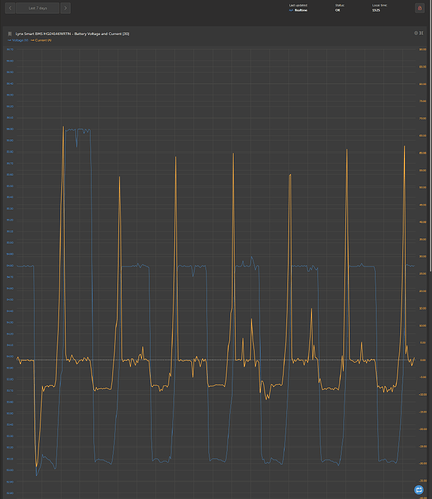

Look here so many days in a row the battery was taken to 56V
Setting it lower won’t cause damage. I’ll try for a few days. for science ![]()

Regarding your remark that sync happens without 56V being reached and the accompanying graph: as far as I can tell from that graph it did go to 56V after every discharge below 70% and subsequently it synced. There are some point at which a spike up is seen but 56V is not reached. However, the spike is there and I suspect the graph resolution is playing parts here. You mentioned using home assistant and I have in my (long) carrier not met programmers that could reliably (with proper math) scale graphs based on sampling. Actually, up till now, Victron has positively surprised me. In short: short spikes often disappear, but to me the graph looks OK.
Also, sometimes syncing does work and a very short absorption follows instead of many hours. This is consistent with my hypothesis (which we share) about the underlying problem. Is is after all also a matter of statistics and it is very well possible that syncing does see a 3 minute 56V period that satisfies it. Same for absorption.

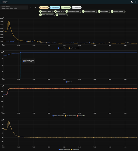

Yesterday I lowered the HA resolution to 10 sec.
Today we will see the sync without 56v, I hope.
