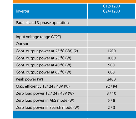

I just received a new Victron Phoenix 1200/12 V inverter (EU version).
The datasheet specifies a zero-load power consumption of 7 W, but when supplying 12 V to the input, I consistently measure around 10 W with no load attached. The fan is off and the unit is at room temperature (~20 °C).
That’s more than 40 % higher than specified, which is very disappointing!
How does Victron officially measure the “zero-load power” figure?

If I’ve got the right product, then the spec is 8-10W.
That’s from the “Compact” MultiPlus, the old model. :wink:
