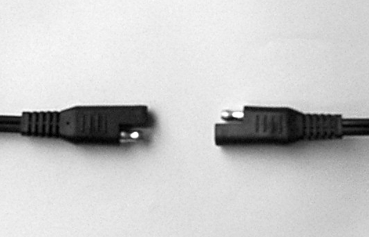

I looked at the Wikipedia page for DC connectors and figure I’ll go with an SAE connector, like the one in this photo:
I don’t have hands-on with this system. I’m inclined to do like Wikipedia says, that is, connect the +ve input on the Victron MPPT to the exposed pin. Look at the photo, and imagine the MPPT offscreen to the left. Its “solar +ve” connection would go to the lower, exposed pin of the left half of the image, and its “solar -ve” to the upper, concealed pin.

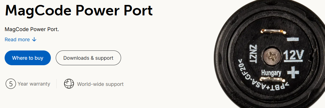

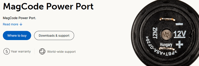

Shout out to Victron’s MagCode Power Port, they’re cute and I’ve always wanted to use one. No documentation on it’s voltage rating, but current looks ok.
The MagCode Power Port is prominently marked as “12v”, so would strongly advise against using it on the PV side of things.
(can confirm they’re super cute, though, I got one a while back just to play with and it’s awesome)

At the camper wall, I’ve used SAE connectors. They’re OK, but many of them are limited to 10 amps. If you wire your panels in series to raise the voltage, then the amps won’t increase. The amp rating on some premade cables with SAE connectors seem to be the rating for the wire, not the connector itself.
