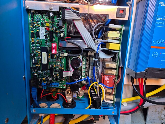

Hello,
I have an old Multiplus 12/1600 with firmware version 1806133.VFF written on the chip (cf. picture attached), and I would like to connect a VE.Bus Smart Dongle to it.
When I plug the RJ45 cable on the dongle, the Multiplus stop working. I guess I’ll need to update the firmware, but I’m not sure if I need to buy the MK3 or MK2 Usb interface.
Could you confirm it is possible, and if so with which interface ?
Thanks,
Mat
