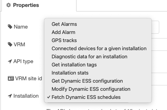

Ah yes, the update breaks the installation stats for DESS (only).
Adjusting to Installations → Fetch Dynamic ESS Schedule should be the only thing needed to adjust on the flow.

Yes, as a side-effect, that moved under installations[“fetch-dynamic-ess-schedules”] now in the global context.
Ok, but is the object structure still identical then? I mean, how deep will this rabbit hole go?
For maintainability and clarity. If we have both in, we will get questions on which one to use.
The object structure is still identical, containing records, totals and success.

So we are talking about the following changes so far?:
  • VRM-API node setting → Fetch Dynamic ESS Schedule
  • Return object global context → installations[“fetch-dynamic-ess-schedules”]
  • Object structure → unchanged
  • (Some?) Array length (s) → quadrupled
  • (Some?) Scheduled duration (s) → quartered (from 60m to 15m)

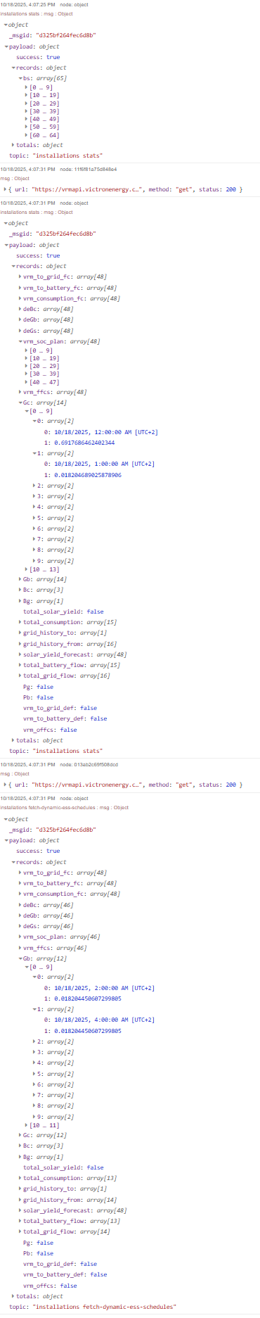

I am loss here. No matter what I do, I cannot even extract the current price.
Getting battery SoC will onluy provide history, albeit in 15 minute time slots
Old installation stats provides hourly time slots, starting at midnight NL (UTC+2)
Fetch schedules provides hourly timeslots, shifted to UTC

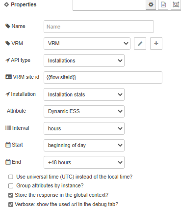

I find it very suspect that the fetch schedules API call URL, calls for “interval=hours”:
https://vrmapi.victronenergy.com/v2/installations/xxxxxx/stats?type=dynamic_ess&interval=hours&start=1760745600&end=1760918399
AND uses the exact same URL as the old installations stats:
url: “https://vrmapi.victronenergy.com/v2/installations/xxxxxx/stats?type=dynamic_ess&interval=hours&start=1760738400&end=1760911199
The prices are stored in the deGs (Grid sell) and deGb (Grid buy) arrays and not in the Gc (grid cost) array. The latter stores the actual total price you paid that quarter/hour.
You are missing the point: the VRM-API Node is broken, no matter what schedules you request. It doesn’t fetch the 15m scheduling object as required. Unless of course you do what you did and bypass the Node with a completely self constructed custom query input, in which case you don’t even need the node at all. And all that was needed was the original VRM-API node to adhere to the set pricing time slot duration of 15 minutes or an hour (or any other duration for that matter). I mean come on, if the voluntary beta testers are becoming the first line of verification, we must be able to tell it as it is, no use in sugarcoating it.
Just updated Cerbo to 3.70-49 but didn’t yet figure out, how to get current price? I only get 46 values in deGb with vrm-api 0.3.6, where as in my Raspi with older vrm-api I get 95 and the last one is the current price.
