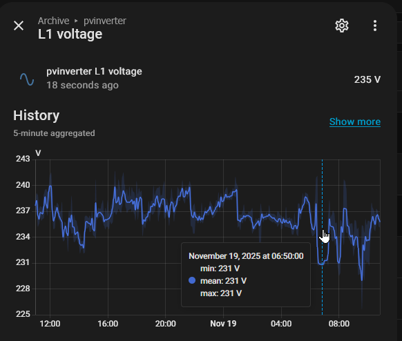

Theoretical 240V, practical (right now) L1 235 ,L2 235 ,L3 234
At the time of the outage, output of the Victron was 230
Image below is from today, mouse is were the grid was down.
The 2 dips after are when grid is live, but the issue happens when grid is live and Victron is set to inverter only so grid stability is probably not so much a factor?

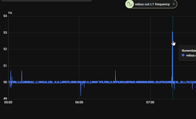

I do believe it’s more of a fequency issue where the dimmers go haywire, I have not seen any flickering on “non-dimmed” lights.
Grid Frequency is stable
Output frequency, peak is when grid came back
