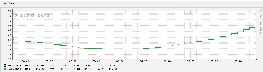

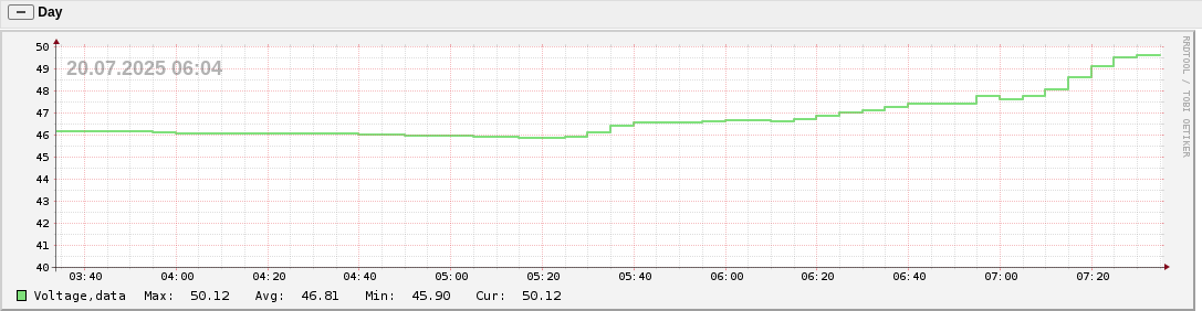

i have sometimes the problem, that multiplus switches off at soc 34,5%
in this case 6:14
The battery voltage is 45,9V
Is it possible to change the threshold value for the low voltage in the multiplus ii ?
Thanks
Thomas

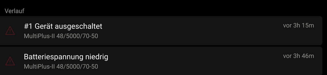

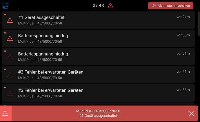

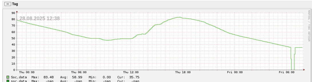

Hi,
i adjusted some settings see here and i have the newest firmware on multiplus ii 5000/48
But now the multiplus switches earlier off :-(.
i hope someone can help what is wrong.
thanks
Thomas
