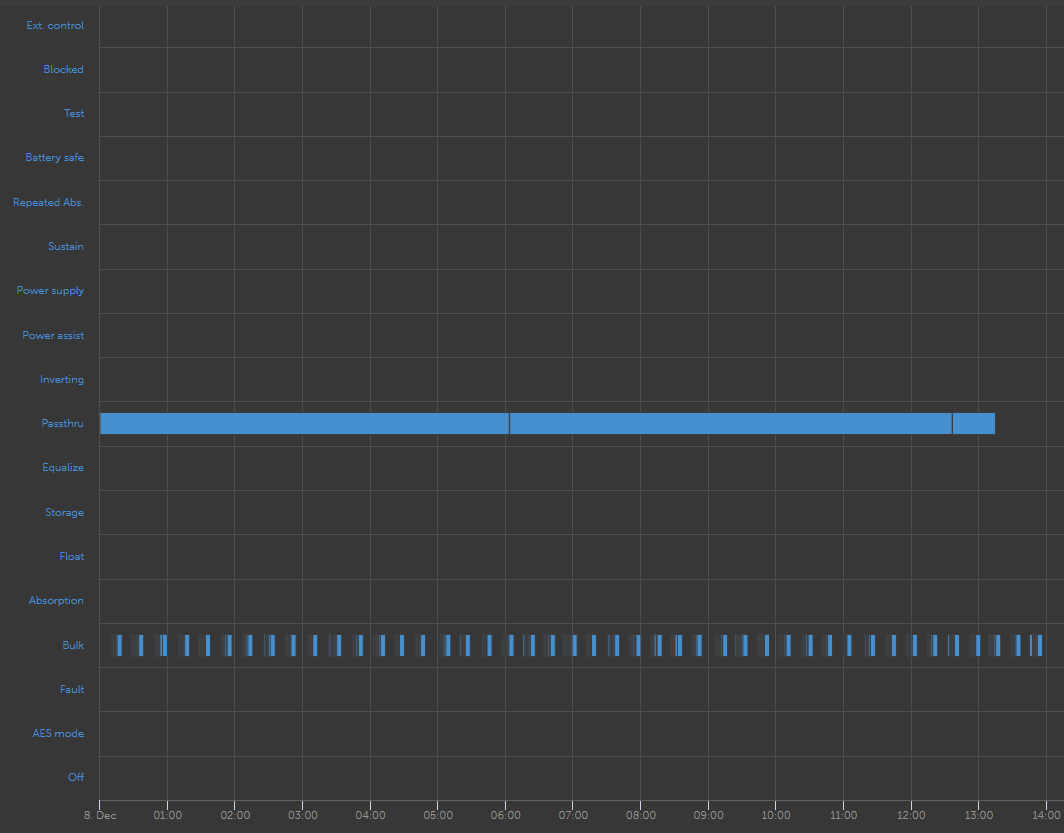

I have recently configured the ‘charge current control’ assistant using AUX1 on the MultiPlus-II connected to the NC Relay 2 on the Cerbo GX. The idea is to use the ‘Relay 2’ switch in VRM to enable/disable the charger. This all works perfectly fine, but since adding the ‘charge current control’ assistant, the MultiPlus keeps switching into ‘Bulk’ for about a second before switching back to ‘Passthrough’. This can happen multiple times a minute with gaps of up to 30 minutes and I have been unable to spot any sort of pattern. Note that this only occurs when in Passthrough and not when Inverting (battery power).

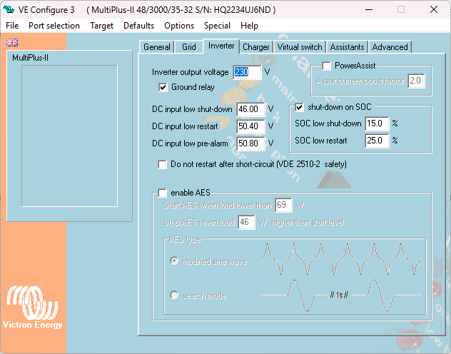

  • Multiple assistants are configured to switch in and out of Passthrough based on SOC (see screenshots)

  • Disabled the charger in VE Configure under the ‘Charger’ tab - no change
  • Disabled VSense in VE Configure - no change

Same here. WIth 3x MP2 5000/48 (v556). 3f setup. I noticed the same behavior.

I’m also glad I’m not alone. I use two assistants. One to ignore AC IN and the other to enable charging using the Rele2 cerbo. This is for full fill info. I noticed this weekend when I was solving something in the technical room. Charging always turns on for 1-2 seconds and before the current can rise, it’s immediately turned off again. So apart from the fact that it’s annoying and strange, I don’t think it’s a big deal. I haven’t tried completely disabling charging as a whole function. But I would have to download the configuration, I don’t have time right now. Maybe on the weekend.

Yes, that sounds exactly the same as me. I did try disabling the charger in VE Configure, interestingly the ‘charge current control’ assistant still works and charges the batteries even though it is disabled in the config! This didn’t make any difference to it switching in/out of Bulk every few seconds though.

It’s possible. Interestingly, no one else has complained yet. I’ve noticed that it sometimes shows up in the console as well. Passthrough / bulk. I don’t know if I didn’t notice it before, or if I wasn’t paying attention.
