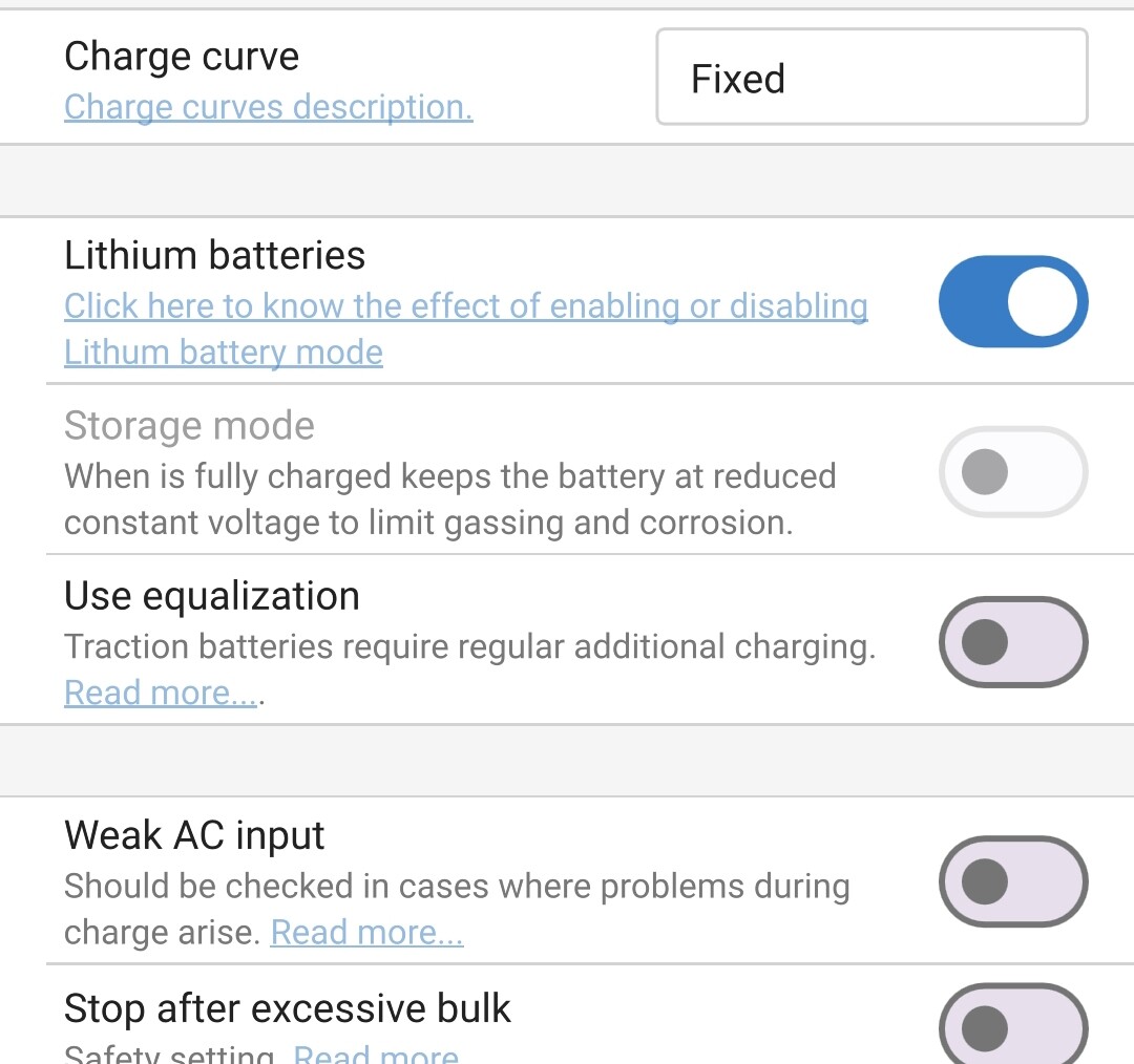

The setting i am referring to is here under charger . It is a small toggle. Normally when you enable lithium it disables the equalisation.
The equalisation is meant for traction batteries.

So I need to enable “use equalization” to make it work from the gui. That explained why I couldn’t start it. I don’t think that option exists within the VeConfigure software. Thanx LX for pointing this out! :+1:
