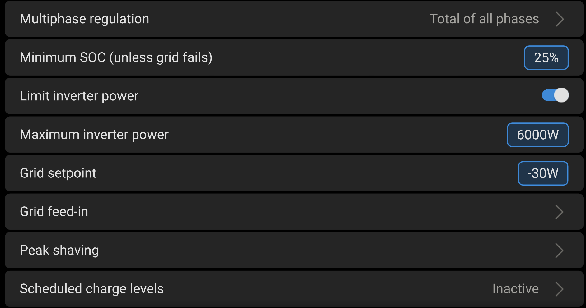

Hi @Blendworth , I’m interested in point #4. How have you set this up? Have you achieved this by setting a negative setpoint during peak rate hours?
@robovanbasten
@Blendworth , do you have the -30W set all the time? Or do you only have that set during peak hours? I force charge my batteries 00:00 → 05:30. Does the -30W setpoint value get ignored during Scheduled charge levels?
@Daza , I had a look at that setting, the default is 50A. If I want to charge my batteries at say 3kWh I’d need to drop that value right down to 13A (i.e. 240V x 13A = 3.1kWh). Is this correct?
@robovanbasten not sure it entirely works as per the calculations I would say adjust it on the fly to zone in on the required kW which may need you to stay up till that off peak and just dial it in that way
