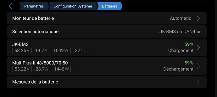

When my LiFePO4 battery reaches 100% State of Charge and transitions into float mode, my MultiPlus GX continuously cycles between charging and discharging the battery, rather than allowing it to rest — unlike my previous Pylontech batteries, which remained idle once fully charged.

I have seen some push and pull from batteries before but not usually at 700W.

Maybe as another thing to check in vrm advanced is what the battery is requesting in terms of CCL and CVL
Why is your battery monitor in ve config set to 150AH but in the JK it is 280AH?
