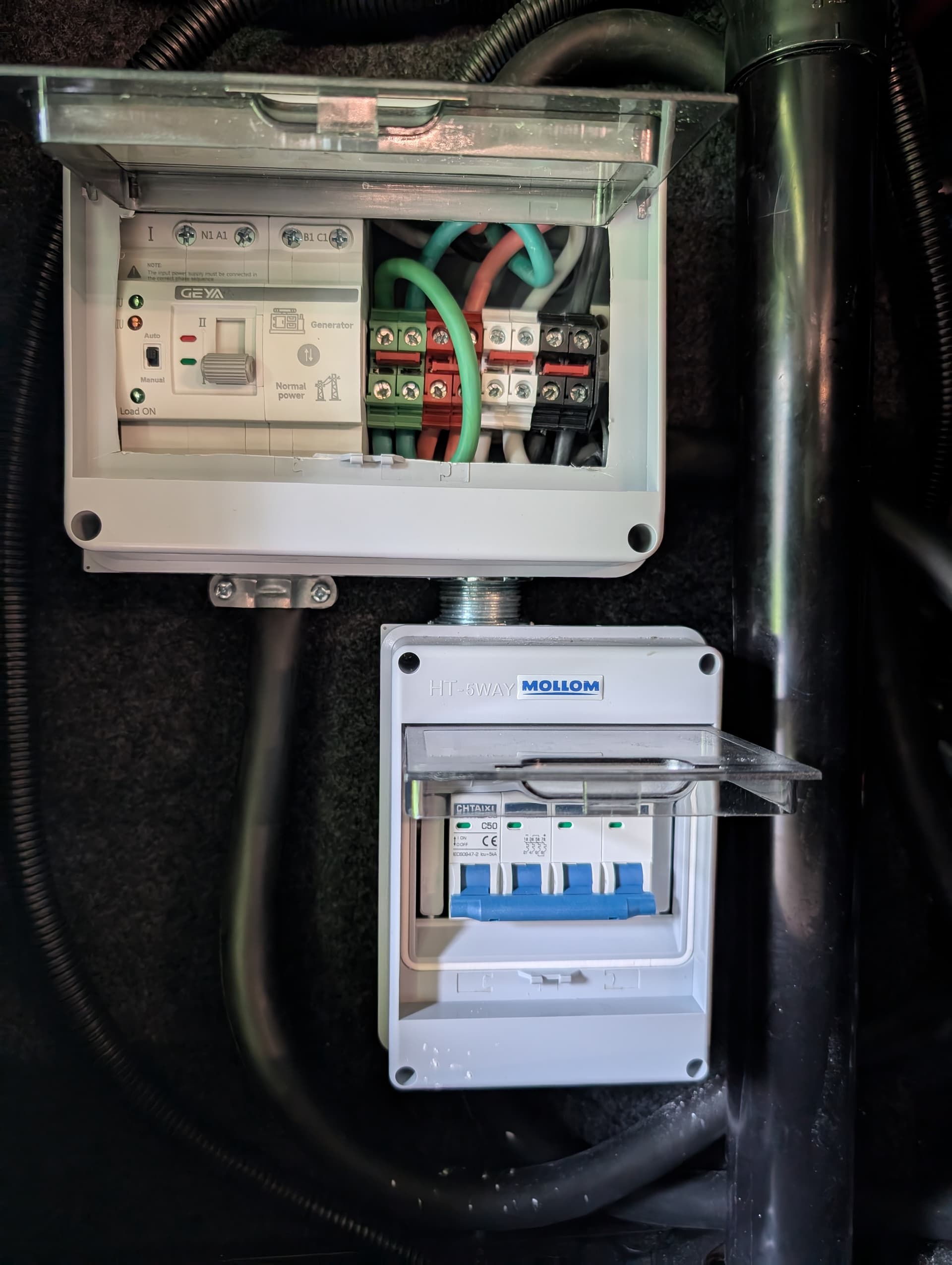

Mine at home is an all in one breaker doesn’t have the little button like other breakers. I bit the bullet and put a bypass loop in so I can shut off power to the inverter and shut off the inverter. I put a DIN ATS on the inverter output so any time the inverter stops supplying power it changes to direct shore power. This removes backup ability, but allows it to work on GFCI as it seems to be a hardware related defect which Victron knows about but won’t address. I am using an 2x120 MPII which I realized is diff from what you have after my original post.
