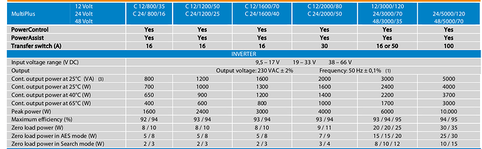

As can be seen from above, the inverter’s continuous power rating at 25C is only 4000W.
If your load has a power factor less than 0.8, and if there are any air restrictions it will overheat at that level.
You should think about adding a second inverter in parallel, or upgrading to a 10kW inverter if your load is that high.
