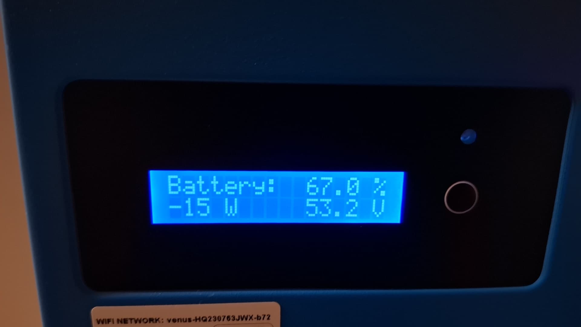

When I disconnect mains and load, the power usage of the multiplus drops to 15 watts while the inverter is still active which is according to the specifications. So grid connection is causing a loss of approximately 100 watts.
