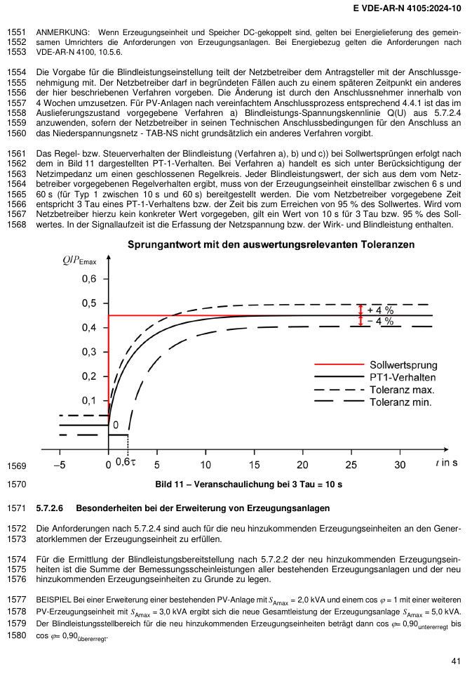

Das ist immer wieder falsch. VDE AR-N 4105:2024:10 gibt 3 Tau für 10 Sekunden und 95% des Endwerts an. Nicht nur für die Blindleistung sondern an anderen Stellen auch für die Wirkleistung. Macht auch mehr Sinn als eine lineare Änderung.

Thank you @thiemovanengelen . However, as you can see in the screenshot of the VDE AR-N 4105:2024:10 @Janvi posted, both the 400W/s I mentioned and the rule “consumption must be limited between 0.33% and 0.66% of the rated power per second” you posted are not correct.

Regarding the screenshot, this specifies the reactive power behavior. Article 5.7.4.1 specifies the active power output and this contains the mentioned limitations.

@thiemovanengelen Thank you for your support! You are right, that article 5.7.4.1 of DE-AR-N 4105:2024-10 contains the mentioned limitations. However, I see two problems:
  1. DE-AR-N 4105:2024-10 is still in draft state and not final yet.
  2. If I understand article 5.7.4.1 correctly, those limitations only have to be applied in case the setpoint is changed by a third party. I actually don’t think that I am a “third party” in my use case.
Maybe there are some VDE experts in the community that know more about this rule that is described in article 5.7.4.1.
Thank you @Thiemovanengelen for the 0,33/0,66% hints. Here is the complete AR-N 4105 draft. The rules for change of P between 0,33 an 0,66% are described in page 46 Chapter 5.7.4.1. Unfortunately, the final versions are not allowed to discuss in public for copyright reasons. Nevertheless, the release do not contain much difference with the draft versions.
