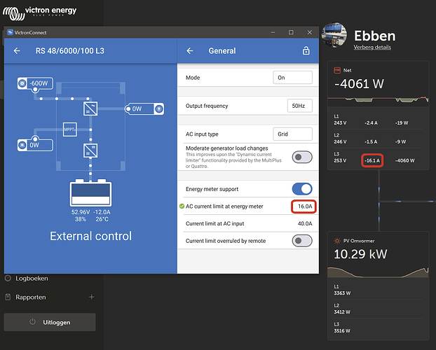

I have set a negative grid setpoint on -6000W on the Multi RS L3, but I am limiting the grid current in different steps to see how the system reacts.
First test: grid setpoint -6000W but current limit on 10A. The system shows a feed in of exactly 10A on L3:

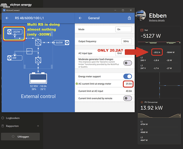

Last test: grid setpoint -6000W but current limit on 25A. The system shows a feed in of 5000W or 20.2A on L1 and it will not go above that value, even if the Multi RS is hardly doing anything:
Now as soon as I disable “Energy meter support”, the feed in goes beyond 30A or 7500W, but since my main fuses are 3x25A, I cannot disable the energy meter support.
I hope this makes this bug/issue even more clear to the victron staff/developers.
