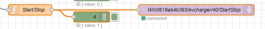

Send value 1 to the mqtt start-stop but the charger doesn’t respond and the value stays on 0 in the mqtt explorer?
The solution for my problem was : topic should start with ‘W’
So when you copy the path from the Mqtt explorer change the W !
So Topic when writing is for example : W/xxxx/evcharger/40/SetCurrent
