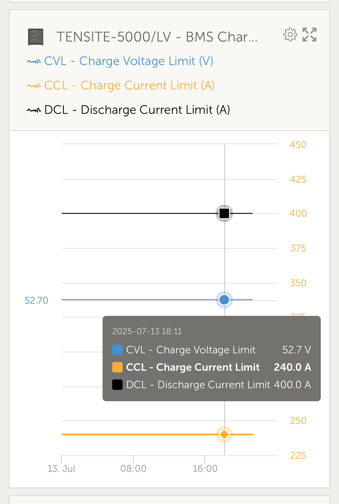

Thanks Nick,
I enclose a picture about the current values.

Do you have access to the battery logs to see if it is reporting an issue?
The BMS isn’t changing limits from the image supplied, assuming the chart covers the tests you have showed above.

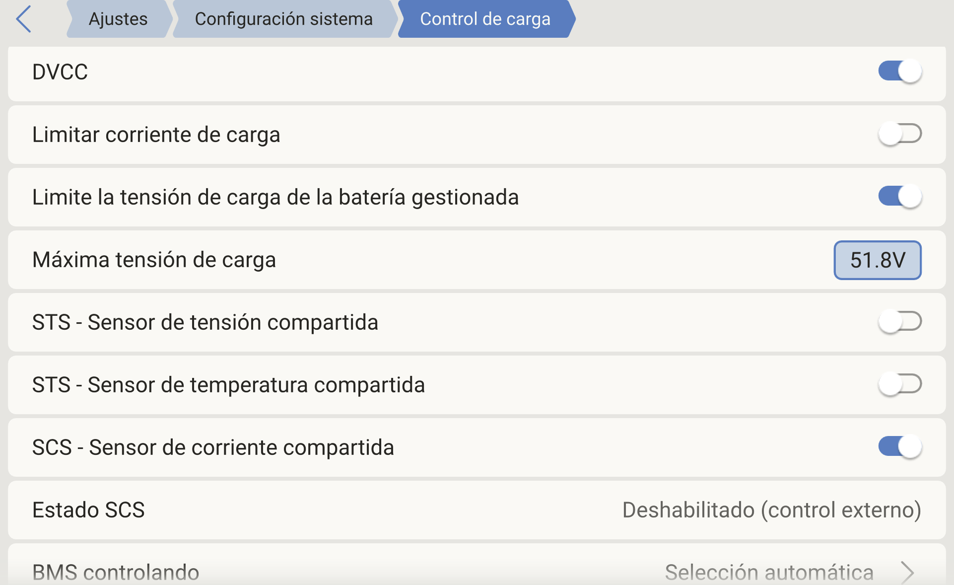

Meant to ask, in DVCC is SVS enabled or disabled?
Okay, at least it was worth a try, good luck with the further troubleshooting

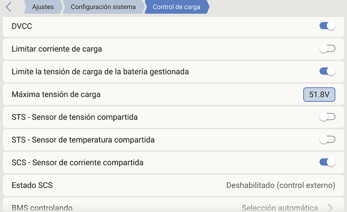

I can’t find the SVS option anywhere. Here’s my DVCC configuration:
Thanks a lot for your help!
It’s the STS due to translation.
SVS - Shared voltage sense.
SVS should be the first one. I will ask to get the translation error fixed.
Try enable this and see if it solves the issue.
Same issue with STS enabled.

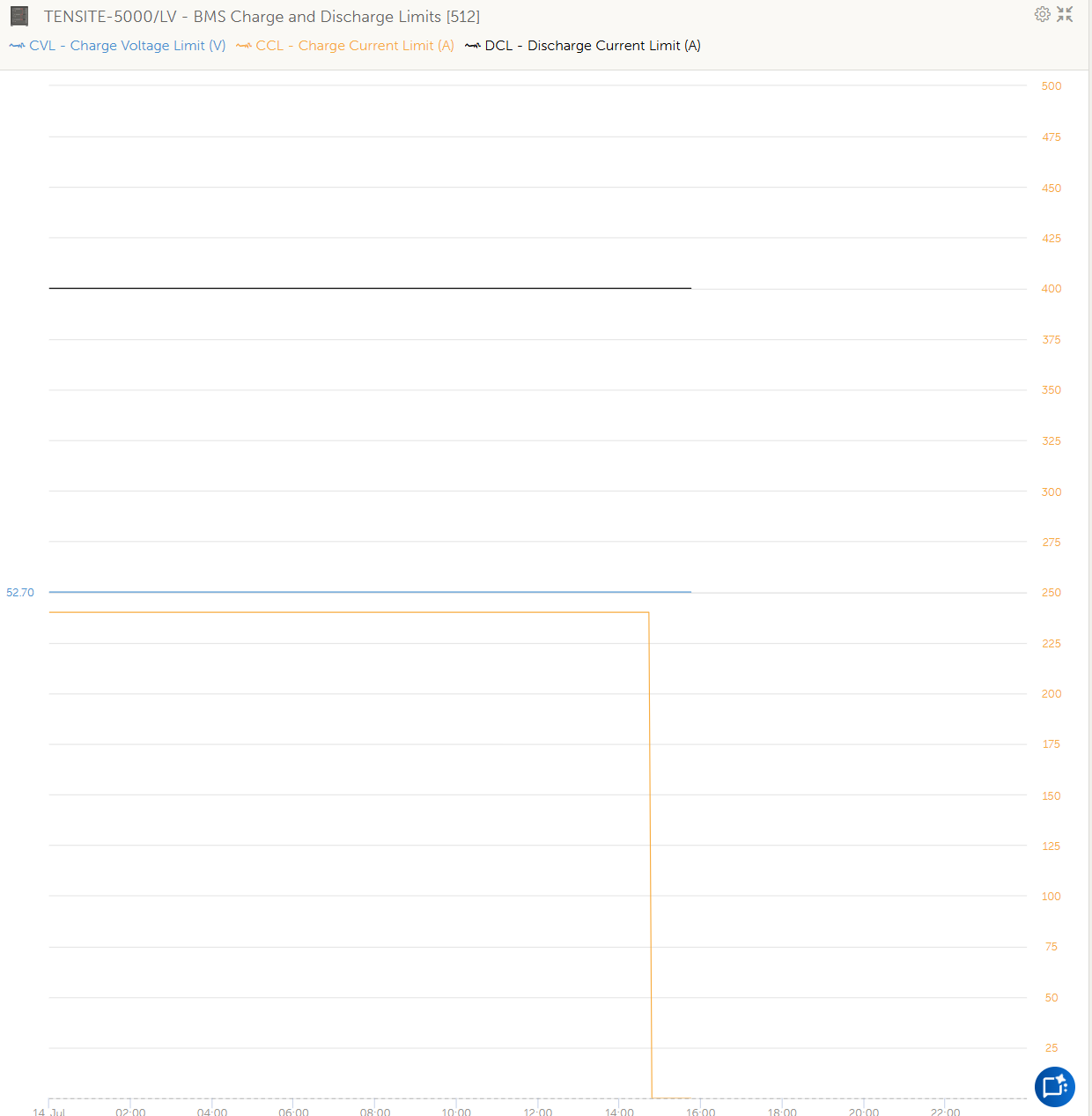

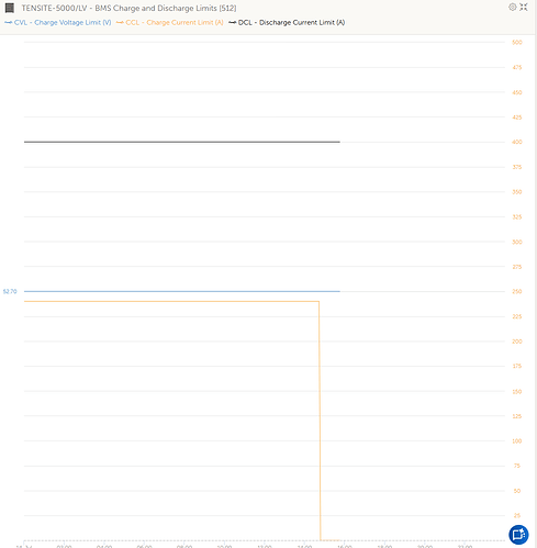

It seems that CCL drops to 0, and that’s when the issue starts.
Thanks!
That’s what I thought was happening but the previous limits chart didn’t show any drop.
When it blocks charge you will have problems. That is the BMS being unhappy, explains why lowering the charge voltage helps, prevents the BMS cutting out.
I think the battery manufacturer needs to adjust their firmware a bit.
Yes, the previous chart was taken during discharging.
