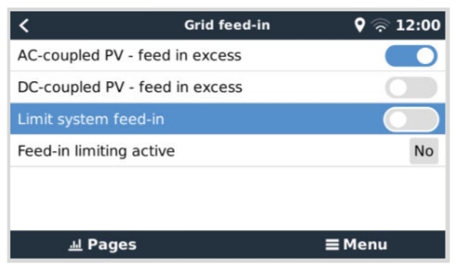

Menu. ESS .
You need to enable DC feed in. The limit is not the problem here.

This also depends on the grid code set in the inverter. However if the PV inverter is on AC out, then dc feed in should start working once enabled.
