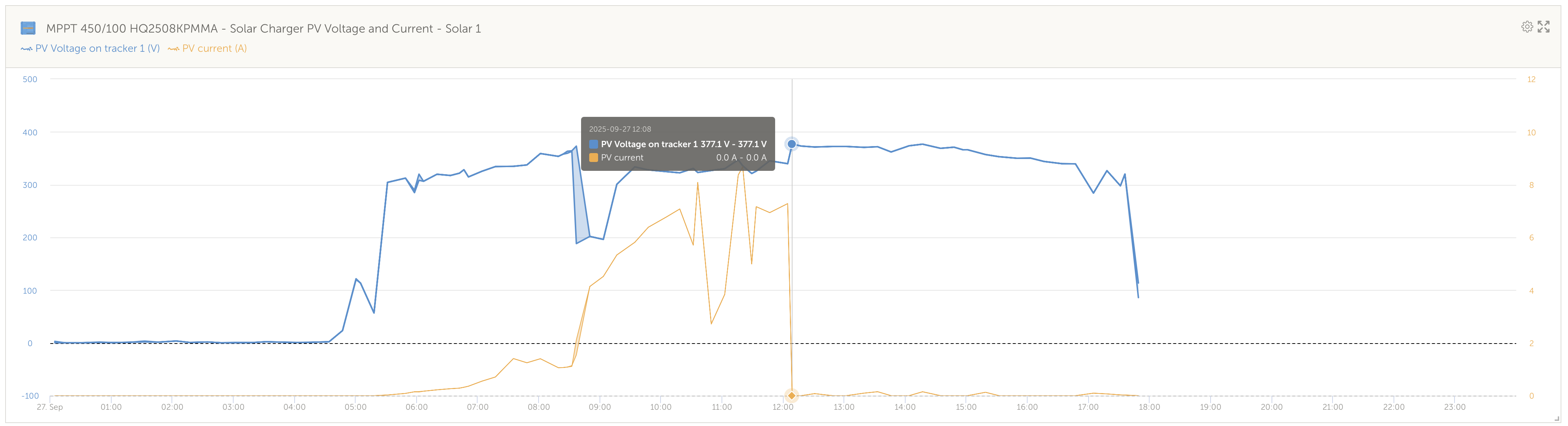

Everything worked for a few months. But all of the sudden the mppt stoped working.
It started with the solar current dropping to 0 while the voltage was still OK.
After a day the mppt did not show on the vrm that’s when I noticed the problem.
A 2 days later the mppt was back online and I saw an error in the remote console “Short circuit”.
One string showed 0V while the other 380V but no current.

After the firmware transfer both strings showed 380V but no current.
The day after the mppt was back offline. And I had time to go over there. The fuse for the mppt was burned. But when I replaced it the mppt did not turn back on.
