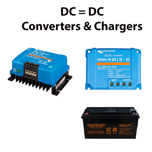

Is the alternator charging a 24V starter / engine / chassis battery. If so then you need to have a DC to DC charger such as a Victron Orion 24/24/17.
dc-converters/orion-tr-smart-non-isolated

How do “isolated” and “non-isolated” converters differ?
Oops, found this:
This article answered my question.
I will need isolated, I think, because the truck and trailer are completely separate units.
On non-isolated the input and output negative connections are common inside the unit. The negative connection is then made to one of the batteries or chassis. The starter and domestic batteries need to have a common negative, either directly connected or both connected to the chassis. This is the route the charging current takes. The isolated version has independent negatives for input and output. Some vehicle builds keep the domestic negative separated from the chassis. In this case you need the isolated version. You can use an isolated version if the domestic is connected to the chassis, it is not usually done because they cost more.
