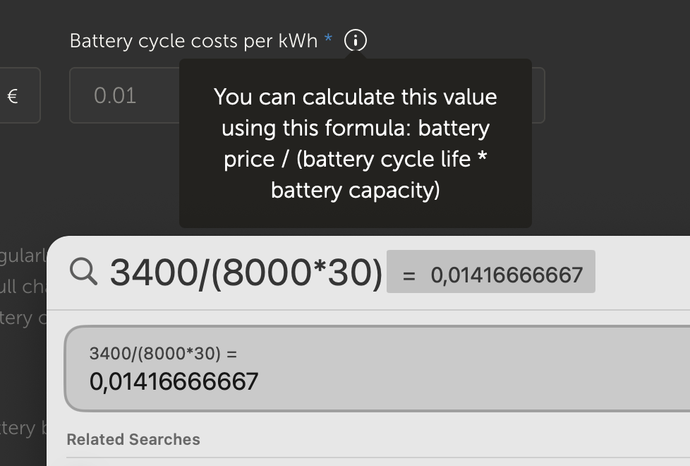

I do not care about battery price, money already spent, device must work.
Also, I have only about 150 battery cycles within a year. With 8000 cycle expected battery life it is >50 years, what does not make sense.
That’s not how it works (the cycle cost is there for a very good reason) but up to you.
I can’t force you to be right.
Ok, and what cycle cost is correct?
  1. €3400 for a 30kWh battery is extremely cheap
    Is that the actual total cost of your battery?
    The cost of my 30kWh BYD stack was over €10000
  2. The battery cycle life is a point of discussion.
    Some use the amount of cycles that the battery is expected to reach over its total lifespan but in my opinion that’s not the right amount.
    Also because battery capacity will be severely deteriorated when it reaches that amount of cycles.
    What I use is the amount of cycles to be expected within amortization and warranty period.
    For my BYD stack that is 10 years and 3000 cycles (counted as the total amount of energy charged & discharged from the battery during the warranty period).
The battery needs to pay for itself within a reasonable time.
Any energy I still get out of it after warranty and amortization is virtually free.
Lifespan of a battery is expressed in years and amount of cycles, whichever is reached first.
Even if you only cycle 10 times per year, your battery is unlikely to last 20 or 50 years and still be in acceptable condition.
In my case that ends up in a battery cycle cost of ~€0.11/kWh.
Since I’m not cycling the battery all too heavy, I’ve set a cycle cost of €0.09/kWh.

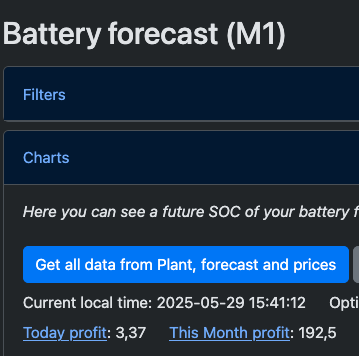

But anyway, according to report in gbb optimizer, this month’s profit is about 200 euro. Same amount was in sunny months last year. So battery will “pay for itself” in 2-3 years.
