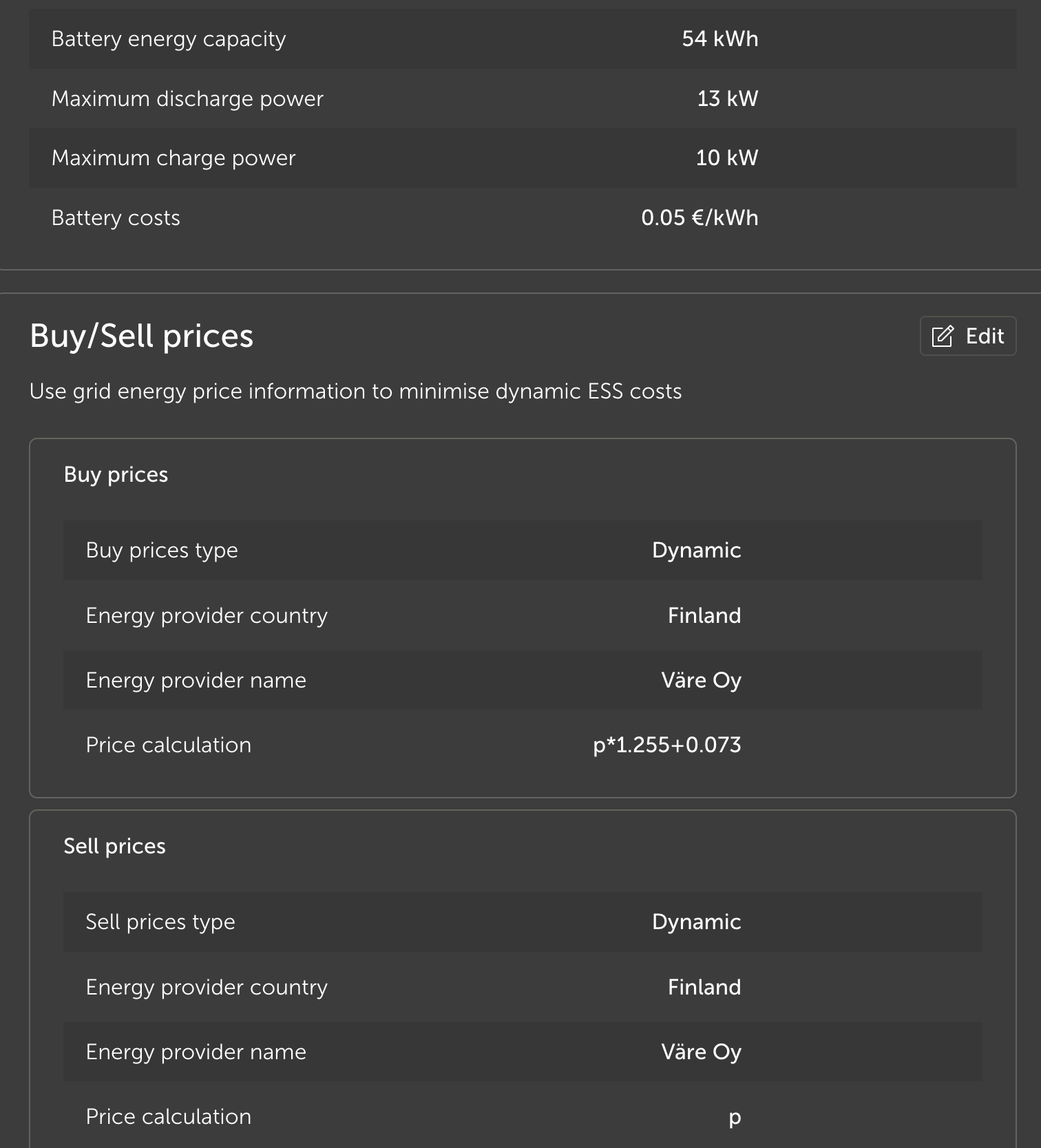

I just had an idea while posting the price calculation picture.
If I overly estimate(say 0,10€ for example) the battery kWh cost. Will this effect the DESS logic at which delta it will export from battery to Grid?
This would remedy the situation completely. I will test this right now. But does someone know that exact logic of the DESS Trade mode if it will include this battery cost to the calculation for exporting decisions? Or is it just for the PnL graph where you can see the daily profitability?

Let’s just keep this thread focused on this. Anyone know if that Battery cost figure does anything?
Yes it allows the scheduler to calculate when it’s cheaper to run from grid energy than from cycled (stored) battery energy and visa versa. Set prices correct and decide whether you need to earn your battery back. If so €0.10 / kWh is a realistic minimum, if not €0.05 will see a lot more trading (=short term profit). The business case with actual write-offs is pretty marginal, lots of big boys eating that cake already. And then things change completely with solar and lenient ‘saldering’ regulations, for as long as that still lasts.
