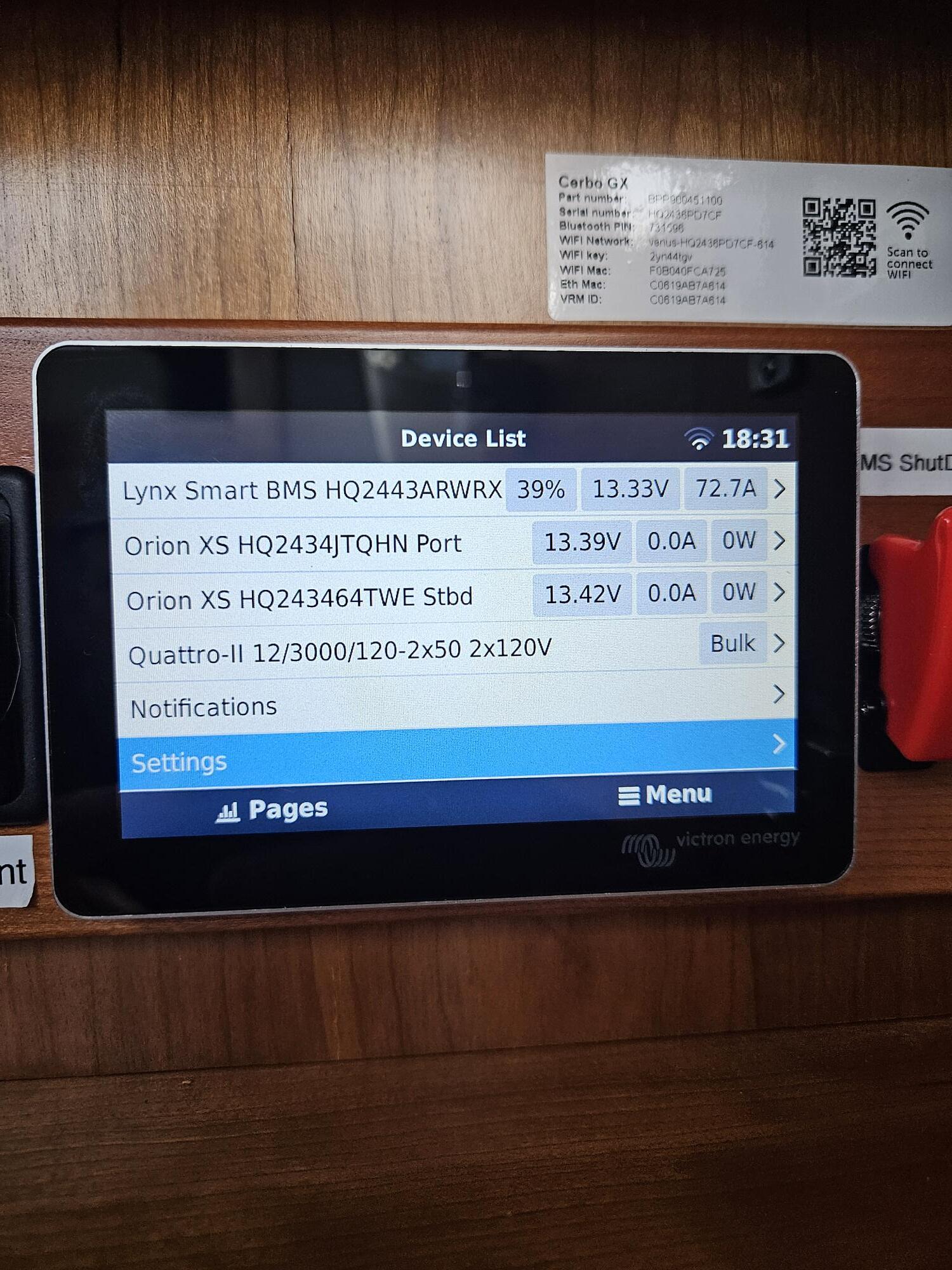

As you said, DVCC is forced ON but “Limit charge current” was not ON. When I turned it ON, it was set to 50A. I changed it to 120a but Quattro is still only charging at about 80a. Batteries are currently at 39% so I think it should be charging stronger.
(attachments)

I figured out the problem. I have “weak AC” turned on in order for things to work well with my older generator. If I turn off the “weak AC” option, the problem goes away and it charges the full 120a. I did install the firmware 556 update (was version 552) but it did not fix the problem. So, I will be charging at 80a max.
