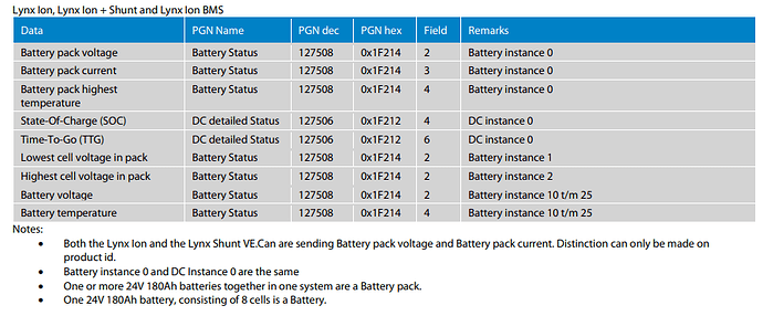

Hello everyone, I have a problem because I can’t retrieve data from my LYNX SMART BMS 500 NG connected to a CERBO GX. The NMEA2000 output is active.
Here are the only values ​​available on the NMEA2000 network:
  • Current battery pack voltage
  • Current battery pack current
  • Maximum battery pack temperature
  • SOC
  • Time to go
However, your documentation stipulates that I must also have access via the instances to the remaining data in the table below:
Attached is the trace of the data sent by the Cerbo GX since it was powered on.
Here are my questions:
  1. Why don’t I have the end of the table? (Specific settings to be made in the CERBO or BMS, etc.)
  2. How can I retrieve the status of the main contactor from the BMS?
  3. How can I retrieve alarms/errors?
