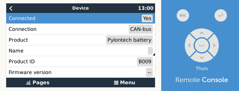

I am getting alarm low battery voltage, which then stops the operation.
When I check the battery it’s voltage does not appear to be low or discharged to a level that is alarming.

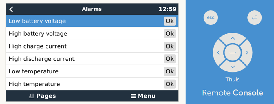

The alarms comming from the BMS are all OK

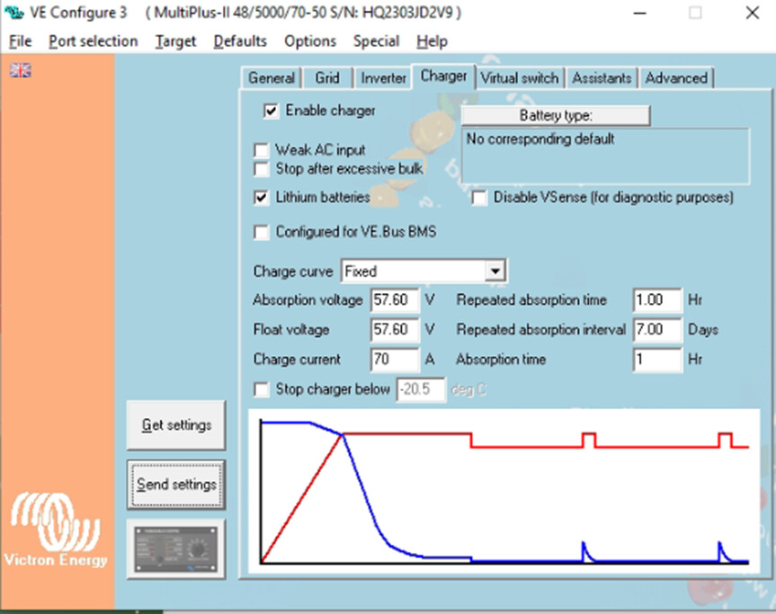

I also checked VE.Configure for the voltage values which are in alignment with the battery manufacturer.

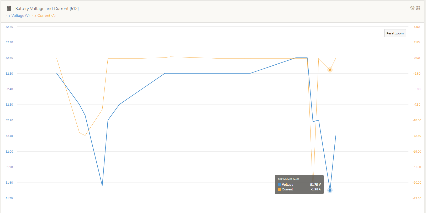

Appears to happen at 51.75v
What is causing the alarms? Is it an actual short voltage sag? Or more a configuration I am missing?

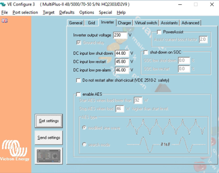

Fixed by implementing the solution on this post :
Just as a sidenode, the official documentation about using Pylontech batteries states to set these values to 46V.
https://www.victronenergy.com/live/battery_compatibility:pylontech_phantom
Dynamic cut-off values: set all values to 46V.
