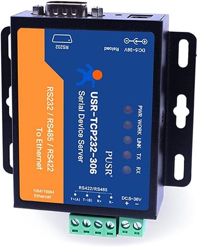

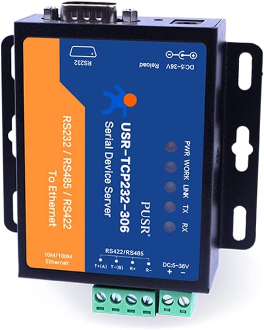

Hello,
You can test it with a low price interface like that :
Tell me if this type of product can help you. We can discuss about this type of interface.
I don’t test it at this time.
We used Moxa box, but the price is high …
Alain
This is Amazons fake copy of a waveshare device.
