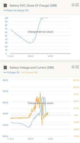

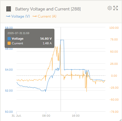

    I read that to garanty lithium life time batteries, it is necessary to balance the Cells at least once a month. In my case, leaving in Portugal, it is automatically done by the MPPT once a day as can be seen on the graph below.
    During this process, 56,8 V are applied for about 45 mn.
    I read also that this process might stress the cells and might reduce the battery life.
Is there a way to control the MPPT to avoid daily balancing and just do it once a week for example?

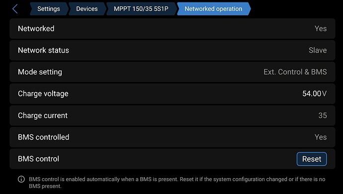

Is charging controlled by the battery BMS with the MPPT in “slave” mode?
If it is, you should see somethng like this in the remote console:

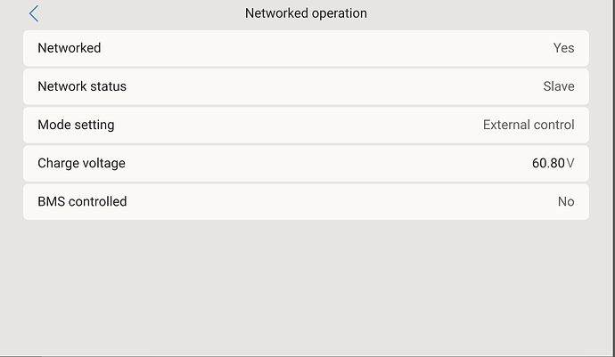

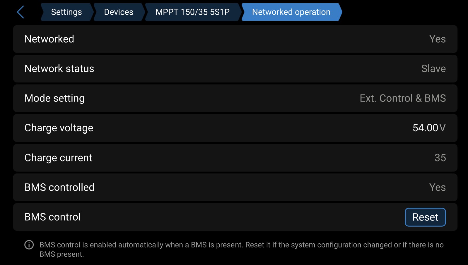

Do you have a connection to VRM (Victron Remote Management)?
Go to this, click on “Remote Console” in the menu on the left, then “Settings”, then “Devices”, then your MPPT controller, then “Networked Operation”.
Yes, I have VRM installed. It seems it is different from yours.
When I access to onr of the MPPT through VRM, I get the following display:
Ten, selecting network, I get
Is that what you are looking for?
If you have the Victron Lithium Smart batteries then exactly which external BMS do you have connected to the batteries.
The Lithium Smart batteries do not have an integrated built in BMS. Victron did sell some batteries with inbuilt BMS that have no comms link to the GX device.

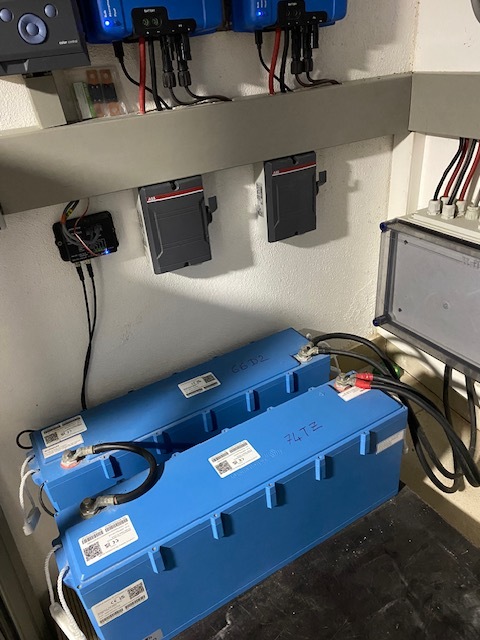

This will affect how the system is integrated and what controls you can adjust. If you are not sure then post a photo.
Inside the battery, there is a BMS which i can access through blue tooth with my phone.
My system is equiped with a BMV and CCGX. I do not know which device is controling the battery. I did not find any place where I modified th 56,8 V except in VE config. I believe that If I do so, the battery will never balance the cells correctly anymore.

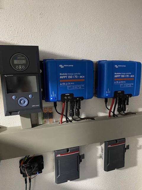

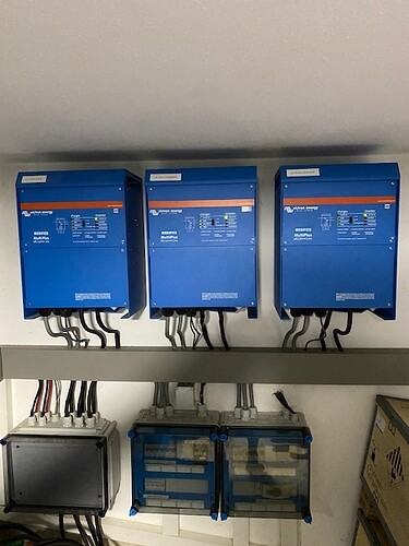

Here attached, the photos of the various equipment.
Thanks for your support,
JM
The Lithium Smart batteries have a Bluetooth board inside which measures cell voltage, cell temperature and balances the cells BUT it is not a BMS, it does not have any safety shut down systems. These batteries have a pair of 8mm communications cables that should connect to an external BMS that is then connected to the CCGX.
The only Victron BMS giving full control of the chargers is the Lynx BMS, the other ones do not control charging. If you had a Lynx you could set your charging to less frequent bit the other ones leave the MPPTs to do a daily absorption.

My battery model is LFP Smart 25,6V x 200A. Effectively, you can see on the photo that there are little black wires which are connected to a small black box with a blue led. This box is also connected to the BMV.
I was told that they battery has inside BMS with protection built in.

Looking at your document, I have a VE Bus BMS which is installed with the small blue box connected with RJ45 located inside the master inverter.
To access the parameter, I need to open one inverter to connect a MKII box and a PC to run VE config.
You posted your photos while I was writing my reply so I did not see them before hand.
You have the VE Bus BMS, it is the VE Bus BMS that has the safety system built in which shuts down chargers and inverters if there is a battery problem, so you have a complete system.
The VE Bus BMS does not control the MPPT charging though, the MPPT settings control the MPPT charging, so you need to modify those with VctronConnect on your phone using Bluetooth connection. There is no way to go to weekly balancing, the MPPT starts a new charge cycle each day. As I wrote above, the way to minimise time at absorption voltage is to change the MPPT to fixed absorption time and set that to 15 minutes.
