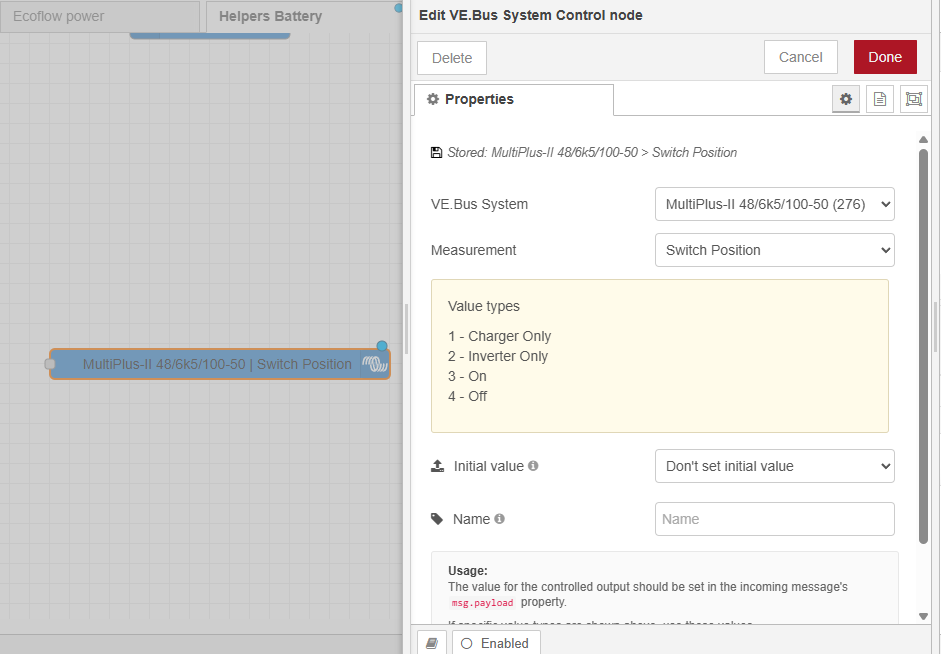

Do you use your VE.Bus Control node in Node-RED?
Thanks! Sure, I’ve had this one too.
