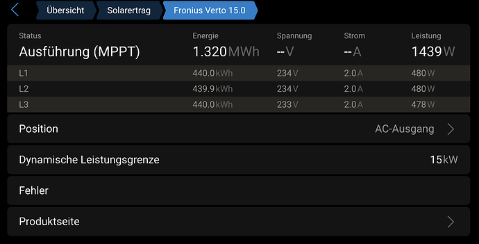

Is Fronius Verto supported by Victron?
The Victron Documention on AC-Coupling does not list the Fronius Verto as being compatible.
However, a recent Victron blog post seems to show a working setup.
Would be great if Documentation could be updated to reflect some kind of status for Verto.
Beyond the limitations already documented for GEN24, any additional issues to expect?
Yes, it will. You just need to enable the API and Modbus yourself in the Data Manager.
