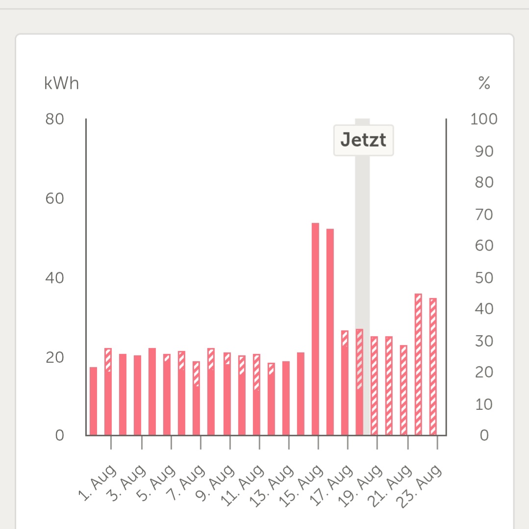

My consumption in summer is always around 20 kWh/day, which the forecast always showed well.
Last weekend, a friend came to visit with his EV, which we charged. See extraordinary consumption 15 & 16.08.
The following forecasts are therefore clearly too high, as no EV has been charged for a long time (months). Very high consumption is expected again for 22 & 23/08 in particular.
That’s what I mean. The two charges on 15 & 16/08 were exceptional outliers which should not affect the future forecast.
There is currently no way to classify outliers as such so that they do not affect future forecasts.
Somehow this needs to be better accounted for with EV charging. EV charging often takes place at irregular times with exceptionally high consumption peaks. It should be possible to take this into account or influence it better somehow.
@dognose Phrased another way, it would be nice if certain measured loads could be specifically excluded from forecasting. I irregularly charge my EV in the evenings on random days, so the system projects a charge every day roughly due to the compounding effect of the irregular charges. I’d rather the system forecast ignore those potential EV charges.
