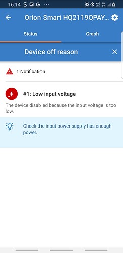

Engine shutdown detection stops the DC to DC charger on low voltage but the alternator could still be working. Do you have a smart alternator that can reduce its charge voltage independently. Could the alternator have a partial failure so it is working enough to kerp the warning light off, but not enough to run the DC to DC. Show us a screenshot of the dngine shutdown settings and the status screen when thus happens.
Hi Pwfarnell, i have done as you said and have uoloaded the screenshots, i went for a drive but it didnt shut off once, however as soon as i drove into my drive and stoppped it shut down so i took a scteen shot, whilst driving it was saying it was bulk charge which is strange as the batteries are fully charge what with all the sun.

And the first is when it shot off

Bulk charge means that the battery is being charged with as much power as the Orion can deliver. For example your house battery may be full and only needs 2A to reach 14.4V, but if the Orion is being limited by a low alternator voltage and can only provide 1A then it is in bulk. Bulk relates to the condition of the charger NOT the condition of the battery.
Is this a new vehicle or charging system which had this trouble from new, or an old system that has worked trouble free and is now having problems.
Anyway, the issue is clearly one of low alternator voltage.
If it has worked well and is now in trouble it is probably a failing alternator.
If you have a Smart Alternator then these can reduce charging voltage on the fly to save energy. DC to DC charging is tricky from these, there is info in the manual, the easiest solution is to activate the Orion from the vehicle ignition key so it always works when turned on regardless of the alternator voltage.

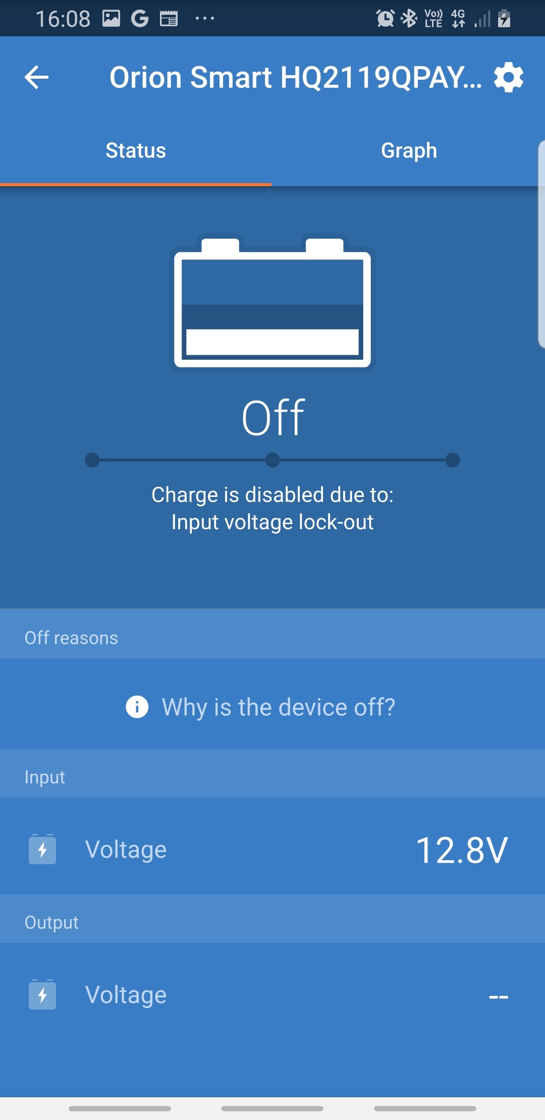

Are you also somewhere that is currently much hotter than normal, alternators can derate if they get hot as can the Orion DC to DC.
As said, with Smart alternators it is best to use ignition overrise for the engine shutdown detection so it does not matter if the alternator goes to low voltage.

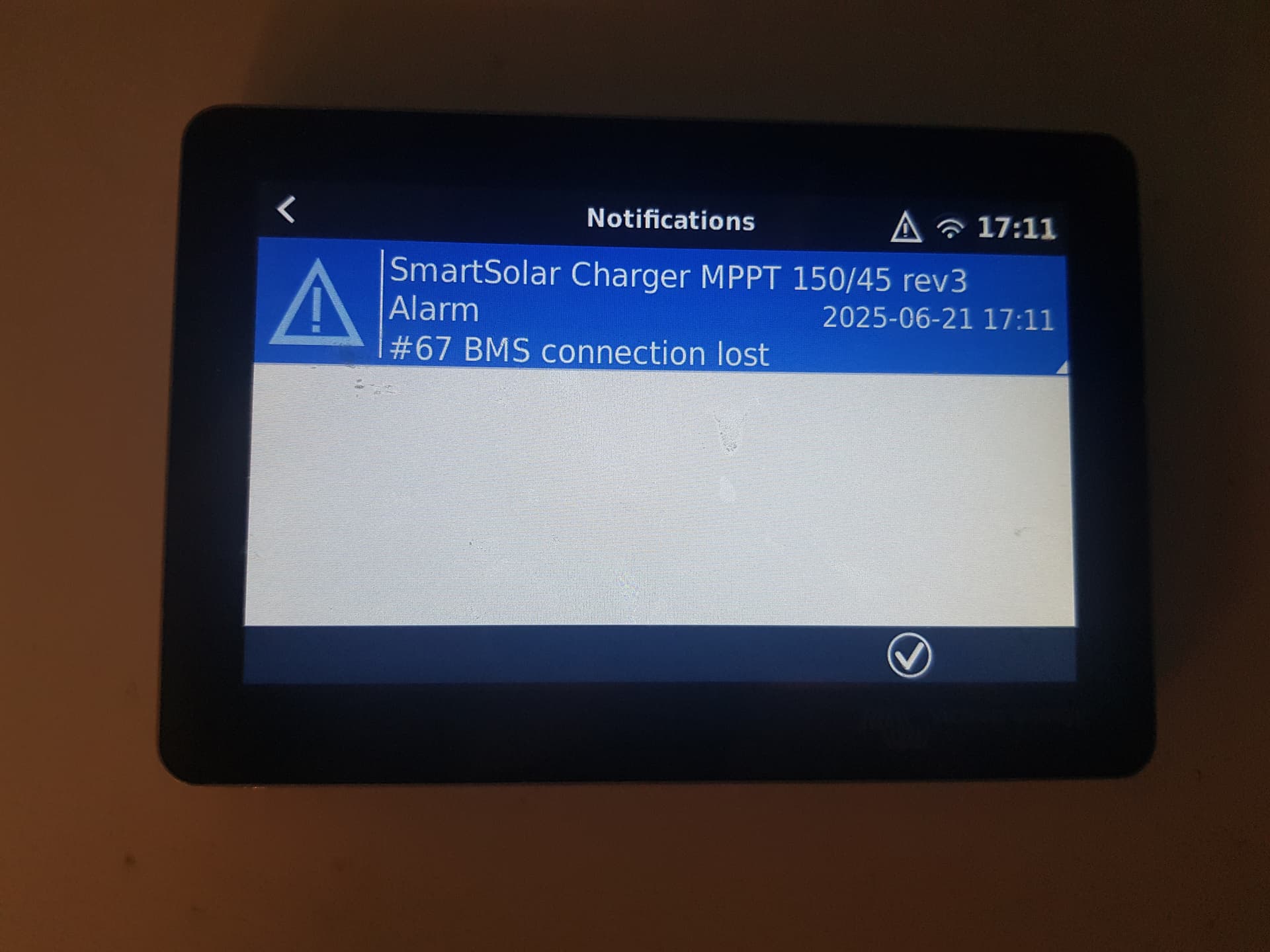

Am now getting an issue with the solar smart lost connection with the bms and very low solar energy being produced, i guess i will be posting a question about this very soon

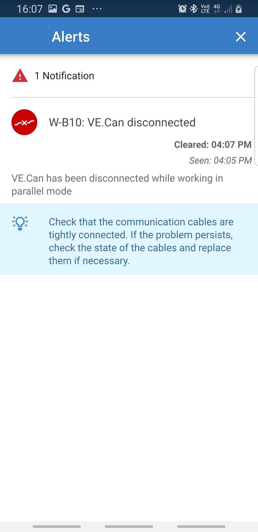

Here are some screen shots i took whilst driving, hopefully they may give a clue
Ok, i think i have sorted the can disconnection, whilst checking the wiring from the battery i noticed i tiny arking sound from the black ve cable going into the bms, when moving the connectiin the ark would increase causing lots of low sell voltage errors thus the battery protect would kick in aand cut off all power, i tightened up the connection to the bms and now no tiny arking
