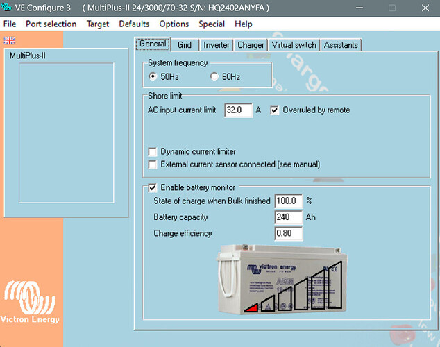

Despite the fact that there is plenty of sunshine, the state of charge remains at 90 percent. Charging parameters are set according to the battery specifications. What could be the cause of this and how can I adjust the SOC values ​​if necessary.

Solved te problem. A wrong setting. State of charge when Bulk is finished. Value put to 100%. Now SOC is 100%.
