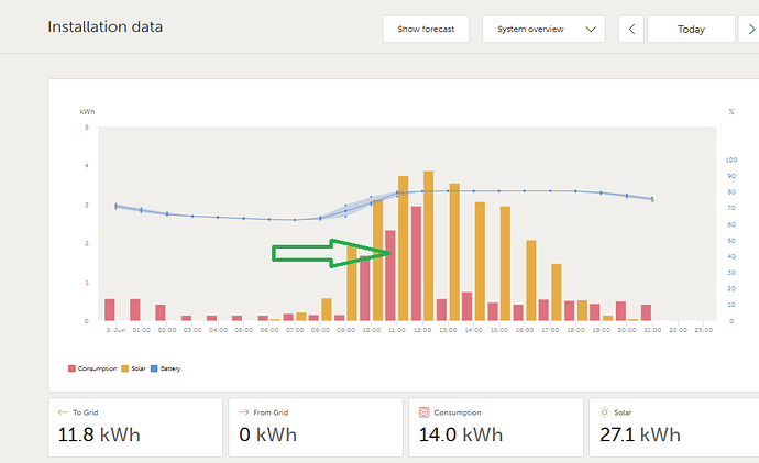

Hi all,
How can I get this data?
Dashboard graph data.

The data field is in relation to the time window selection “today” and therefore not a real-time variable used in Node-Red to my opinion. What you can use is the Yield data from the solar charger node and other nodes.
Hi Gerd,
In really I would like to record all my historic consumption, on my own database. The “red bar” data.
Is it possible? How to recovery my historic “Red bar” values?
I am a developer, so I can write a program to do that, if I know which service give me that values. VRM API? Which service?

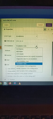

If you want to collect the data in separate database, why to not use VRM API to fetch them?
At the end, from NodeRED you need to send the data out to some database.
You can connect to the VRM API from any host in the world, and in my opinion it is easier to implement this that way.
@psper
You will have to set up your own api token access etc.
In node red -the custom api node in the victron pallette allows you to pull data from the api.

The victron api using node red on a victron gx?
What are you using or wanting to use to access the api?
Link to widgets/graph endpoint → VRM API documentation
a1, a2, a3 are the attribute codes for consumption on L1, L2 and L3
