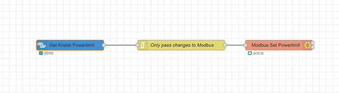

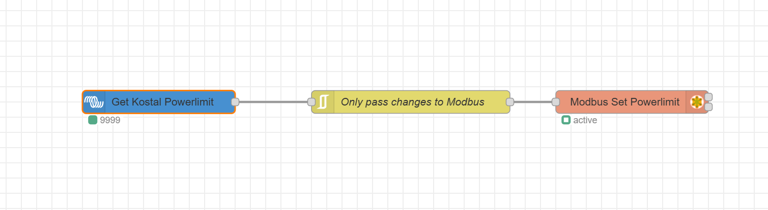

As a quick and admittedly dirty workaround, I set up a very simple Node-RED flow. I’d never used Node-RED before, so there are probably better approaches—but this one works:
This flow reads the limit that Venus OS calculated for me and passes it to the inverter via Modbus. It works like a charm. For my Kostal Inverter, it’s register 832.
So yeah—almost working.

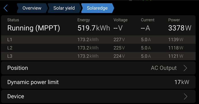

Can report that Dynamic power limiting works really well in SolarEdge SE16K (fw 0004.0023.0036).
VenusOS: 3.70~23
There is only one potential issue. It typically occurs on semi-cloudy days when clouds briefly pass over the solar panels. During these moments, the grid export power drops, the dynamic power limit resets to the inverter’s maximum power, and when sunlight returns, the power spikes over the limit. However, the power limit reacts too slowly and often overcompensates, sometimes dropping to 0W before eventually stabilising.
One possible solution would be to set the power limit to grid feed-in limit + consumption instead of maximum PV inverter power.
