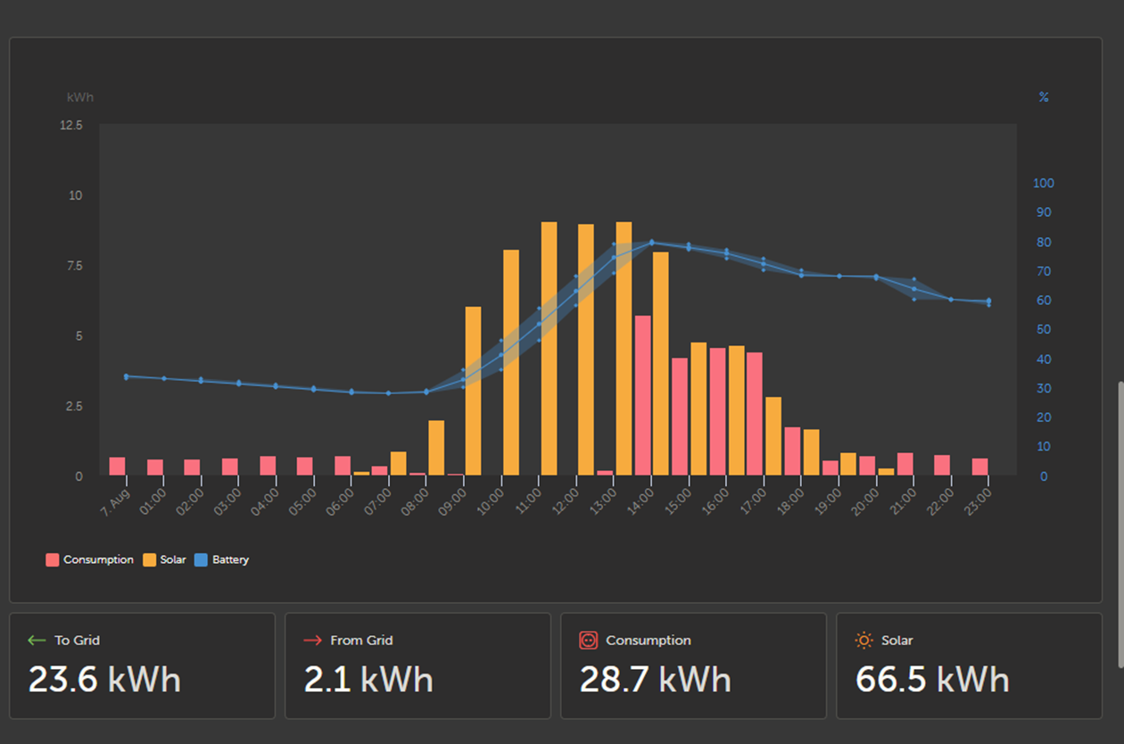

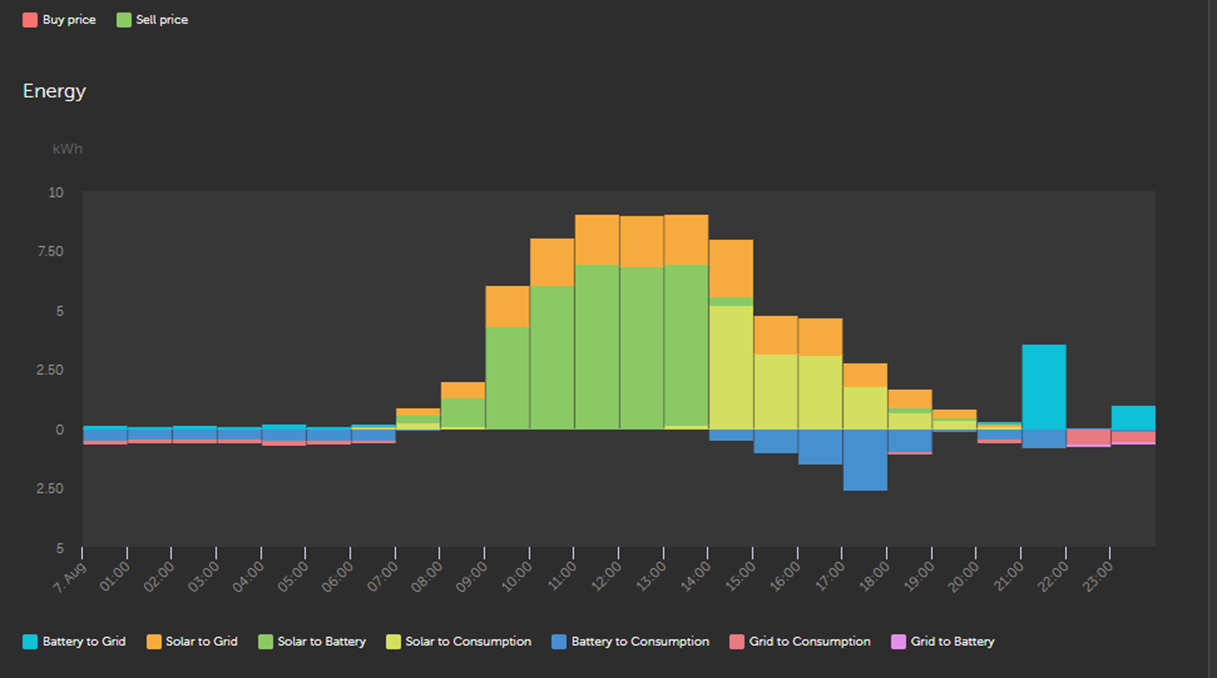

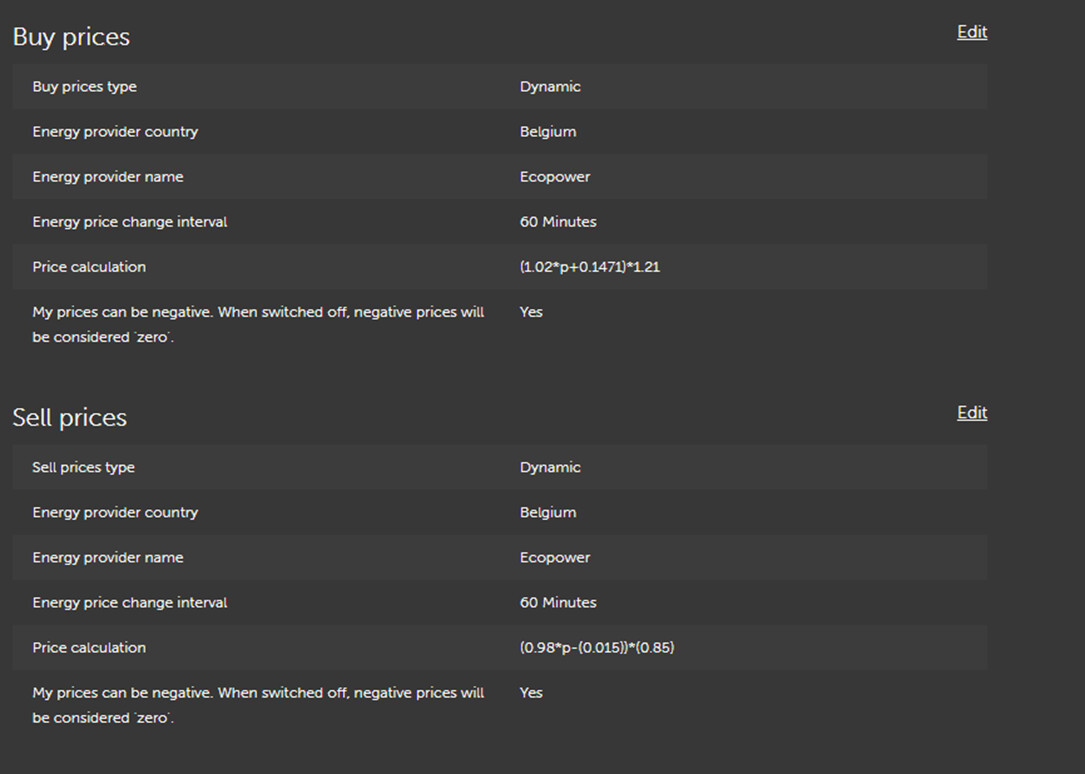

I’m reaching out regarding an issue I’ve observed with my Victron DESS system. The system appears to feed solar energy into the grid even during periods of negative electricity prices, which seems counterintuitive and potentially inefficient.
Here’s a brief overview of the situation:
About two months ago, I performed a system reset to refresh the forecast data.
System runs in Green mode.SW version 3.63
After waiting 28 days for the system to stabilize, I began a detailed evaluation.
Since then, I’ve consistently noticed that the system continues to export solar energy to the grid, even when prices are negative.
The battery has sufficient capacity, so storing the energy would seem more logical than exporting it at a loss.
I’ve attached screenshots that illustrate this behavior. My question is:
Is this expected behavior for the DESS system, or could this be a configuration or logic issue?
Personally, I believe this should not happen under negative pricing conditions, especially when battery capacity is available. I would appreciate any insights, suggestions, or similar experiences from the community.

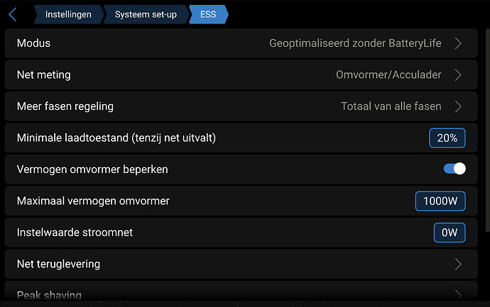

Think you have more solar power available than the chargers can dump it in the battery.
I have a 3 phase 3 multiplus 5000/48/70 so capacity should not be a problem.
in settings→ess do you maybe have “Limit charge power“ enabled?
Or in “ve configure 3”" under charger check if charge current is 70A.
The last sentence on the attachment is turned off
Is 70 amps
Switched to new UI, looks different!
See modus is different, maybe without battery life you get “Limiet laadvermogen“?

Ik krijg geen limiet laadvermogen zoals je kunt zien Ik Heb versie 3.63 en jij?

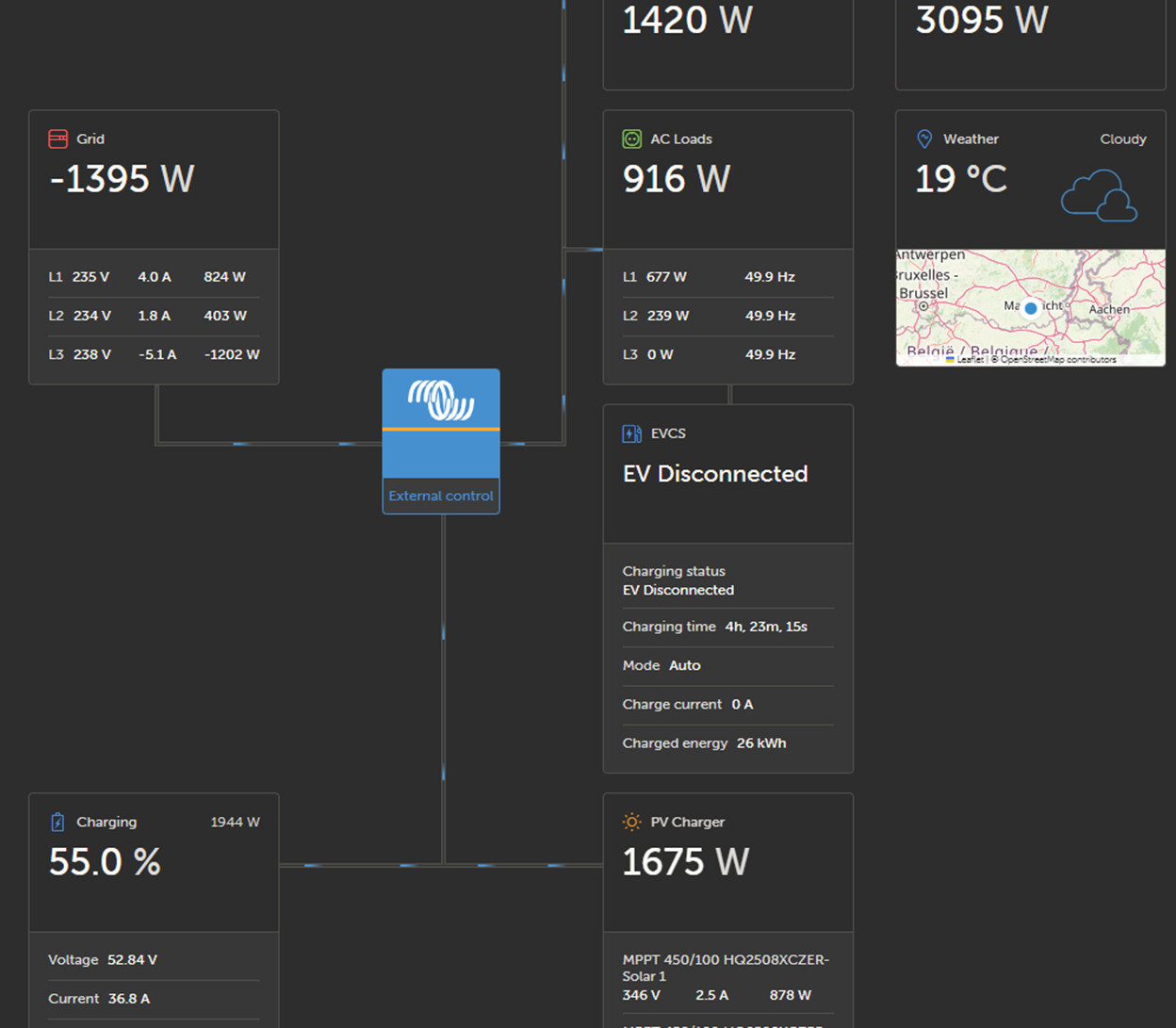

Nog een idee.
Het kan ook nog parameter CCL zijn.
Dat Is de maximale laadstroom en is afkomstig van de batterij BMS.
Kijk onder BMS en dan parameter.
Ik heb 4 boxen en de laad en ontlaad stroom staat op 100A per box
Jk BMS, heb er 6 van 15kWh staan :slight_smile:
Test morgen even wat de max laadstroom is.
