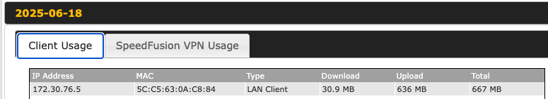

Since getting updated to Venus 3.60 on my Cerbo, I’m using 500MB/day in bandwidth from my Cerbo to mqtt40.victronenergy.com

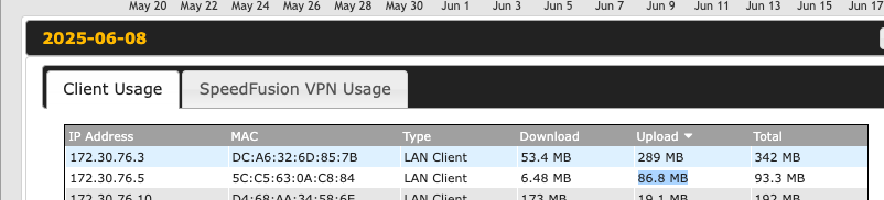

Prior to 3.60, I was using 50-85MB/day (still very high), but now it’s crazy high.

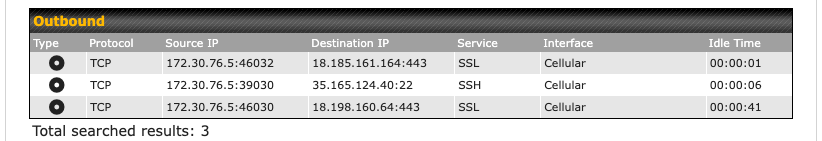

On the Cerbo, I verified that the IP address and process being used was flashmq.
PING mqtt40.victronenergy.com (18.185.161.164)
root@victron:/var/run/flashmq# netstat -tun | grep 18.185.161.164
tcp        0    558 172.30.76.5:46032       18.185.161.164:443      ESTABLISHED
tcp        0    562 172.30.76.5:46032       18.185.161.164:443      ESTABLISHED
tcp        0    374 172.30.76.5:46032       18.185.161.164:443      ESTABLISHED
tcp        0    470 172.30.76.5:46032       18.185.161.164:443      ESTABLISHED
tcp        0   1360 172.30.76.5:46032       18.185.161.164:443      ESTABLISHED
root@victron:/var/run/flashmq# cat vrm_bridge.conf
bridge {
  protocol_version mqtt5
  address mqtt40.victronenergy.com
In the above, the two connections on port 443 are for MQTT (flashmq), and the port 22 (SSH) connection is the reverse proxy my installer is using to monitor my system remotely from VRM.

As stated, this behavior is new since 3.60, as I was running 3.55 prior to a few days ago. The site in question has limited connectivity, so using 500MB/day means that in a few days I will no longer have access, as my connectivity is limited.

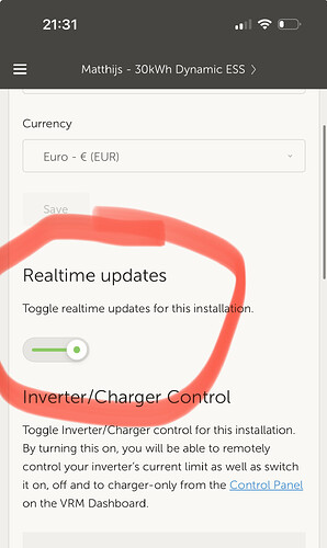

The configured interval is how often the Gx should send data to the vrm database.
Totally separate from that is the mqtt stream of data. Which is on change, used for the real time feature in VRM, used by Grafana, and its active as soon as anyone of those tools “asks for it” (= sends keep alives).
In VRM, per installation, you can disable real time updates.
By doing that, it won’t set up the mqtt link, and then VRM uses no further data.
Note that that data link is only active while having your browser open.
I hope our VRM manual explains that setting in more detail? Can’t check now myself.

I had already disabled real-time updates (as mentioned in my original post), simply because of the limited bandwidth I am forced to deal with.
Ok.. but then I don’t understand this question?
VRM won’t fetch real time when you have real time updates disabled in VRM.
