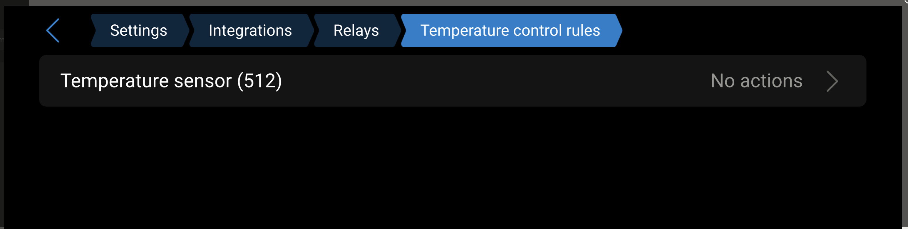

GX: How to use the new battery heating feature for a Pylontech?
I’m trying to configure the Cerbo GX relay for the battery heating.
I have Pylontech US5000 batteries and the BMS sends cell temperature data to GX.
But I don’t have the “House battery 1” under temperature control rule as it is in the release presentation.
Should I have it there?
Or am I doing something wrong?
That sensor 512 is from your battery. Setup the actions on that sensor.
I will report that the sensor should be named to match the battery.
