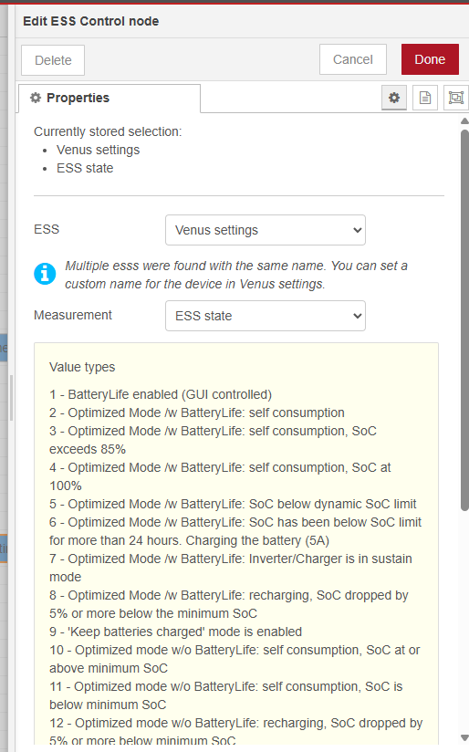

I can use node-red to switch to “Inverter Only” mode, but I’d like to find a solution which allows us to keep the system “on grid”. I can turn off DESS temporarily, but then the metrics get thrown off slightly and the DESS plan takes a while to update to the new SOC (resulting in a brief charging period from grid as the plan updates).
