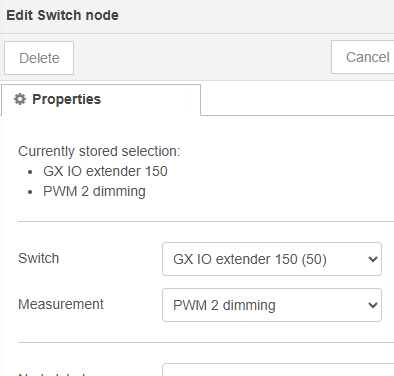

Just wondering whether you got the PWM to work because I’m not having much luck? I can get the state of the port to change (ie low or high)
, but PWM mode does not work.
Works:
doesn’t work:
Got PWM to work. Needed two Switch nodes: One to set the PWM State to 1, and another to set PWM Dimming to whatever you need.
