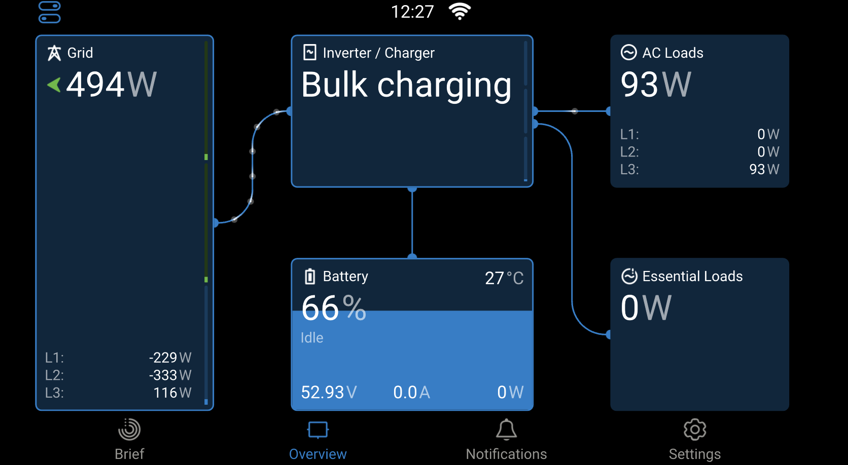

My battery is not charging when my solar is producing more than my house is using (battery at 60%)
It charges fine from the grid, when power is cheap, but I was expecting it to use my excess solar poer to charge the battery.
ESS is activated, and i have a MultiplusII 3000, cerbo gx, and 3phase energy meter installed.

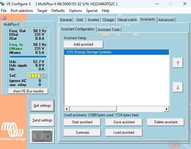

Please include your “ESS Assistant” configuration.

How can i include the ESS setup, is there an easy way.
You can post the ESS settings via VE Configure … summary ESS configuration … Here, the voltages must also be adjusted to the battery system.

Not sure where to find the ess summary..
take a look …
you need an extra meter for your PV on AC in …
Ah I see the system cannot figure out when the grid-meter is measuring negative, then i am producing to the grid, it need a seperate measurement from the pv system.
YES … you have an “old” PV System with NO Communication to Victron … like Fronius … so you need this meter … configured and Position as PV on AC In …
