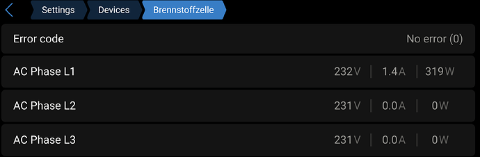

We have the exact same problem here at a customer installation: EM24 (3p) set to Role “Generator”.
Does not show up in either Remote Console (GUIv2) Overview or VRM Overview, but Energy is counted as “Generator” in VRM (Green Bars).
How can we get the Generator-Meter to show up in the Remote Console?
What is also strange: In the Device List it is listed as “Not Connected”, but inside of the submenu it will show values as if it is connected just fine.
Are those Software Bugs or are we doing anything wrong?
