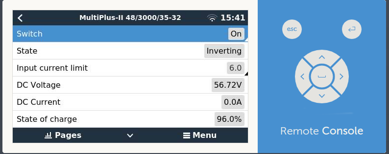

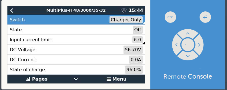

This is what the UI looks like now, while the switch is in the “II” position.
This is what the UI looks like in “I” position
