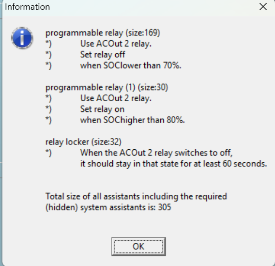

Assistant rules are as follows:
It used to be on at 92%, and off at 85%, since the battery pack was smaller (just the 2x 3.5kw pair). And that worked fine.
I don’t think adding the new battery is causing this problem. All the specs, stats, max charge amps, etc all look right at various states of charge.

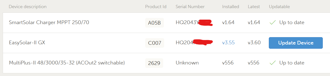

Upgrading the victron firmware though was a pretty hefty leap in version numbers (~2 years worth of updates) and I had to re-create the assistants.
I’m fairly sure I made them fundamentally the same. But it might have been that I was using “Charge State” before instead of “State of charge” I’m not sure, and VeConfigure doesn’t elaborate on the differences.
The problem is, once the SOC goes below 70, it cycles on and off every 5-10 seconds. I added a relay locker of off = 60 seconds, and then I get on for 5, off for 60, back on for 5, …
Pre Upgrade, it wouldn’t come on again until it hit the high level (80% in this case). I’m not sure how it’s possible to be turning on now at 68% only to be turned off again 5 seconds later.
