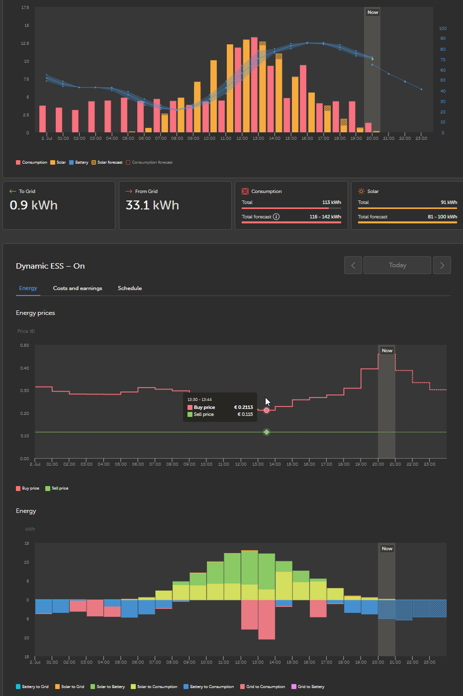

So I am trying Dynamic ESS however, it is not proving very successful, even though my use case is fairly straightforward. I have had it on for almost 2 months and I am pretty sure it’s costing me a more than what I used to do! For example, the day attached.
Despite it being clear that I should have survived almost completely on the battery all day, it was still topping up during the 14p periods, which then means, when I get to the end of the day, I forgo the better 5p rate overnight. And also, it was drawing from grid in the 14p periods in preference to using up the battery that I had bought in at 5p.

At my system the forecast is completely wrong sometimes, anybody having the same?
No, it’s nearly perfect here:
