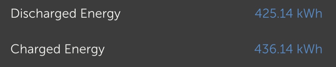

Do you have DC kWh measurement as well? Should really get an idea of the efficiency of this cheap Chinese battery I’m using now before I (don’t) order another one.
Of course. SmartShunt data (Advanced → SmartShunt - Battery History):
Note: my latest new battery pack in test setup.

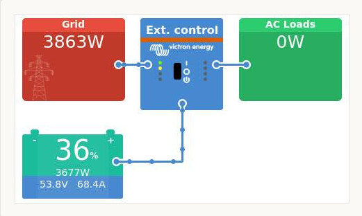

Don’t want to put gas on fire, but on official documentation it says “Maximum efficiency 95%”.
By that maximum, I, for one, understand that only in certain (ideal) conditions will get to 95%.
In all others, that efficiency could be (and is) lower.
You presented in the first post a particular case where you are using about (if not) the maximum power the MP2 5000 is capable to deliver…
Take a look at this: Multiplus-II 48/5000 efficiency curve - VictronEnergy
Also take into consideration that a grid injection could be subject of rapid power variations and the Cerbo is not always capable of showing you the instantaneous power. You should observe the injection power for a longer period of time and get from there the maximum value and that should be considered when you are computing the efficiency.

Look at my charge results of just now, perfectly fine and acceptable. Where did they go wrong with the discharge?
I’ve tried to suggest an explanation here, in the last paragraph… Disappointed in export efficiency - #56 by alexpescaru
